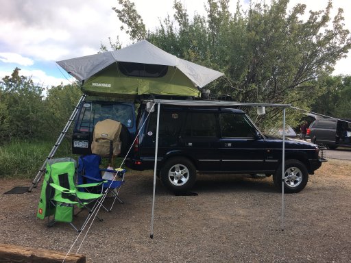

I hear ya. I buy aftermarket when I know the OEM part is not the best, like bearings, brakes, brake lines, etc. Pretty much anything in the drive line from the TC back. I stick to OEM for the engine because why mess with perfection :wink:.
Thanks! It's pretty much stock with bigger tires. I plan to swap out the air bags and do a mild lift this summer. Then maybe skids, bumpers, and a Gobi rack once I have enough equity in my house to take out a HELOC haha. Bigger pictures here.

Oh man, that rig is soooooo nice! I don't know if mine will ever look as good but I'm tickled to death that you have this sweet rig. I'm good with the chewed up shoes, it won't be the first time or the last.
My son lives up there in Colorado City and in the process of building his 1996 GMC suburban 4x4. I plan to come up that way in early summer to trail with him. Maybe we can get together if your interested. I also plan to go to expo in Falstaff this year. Let me know if your have similar plans.
What lift do you have on your girl (or boy)? What size tire ? What kind of front and rear bumpers do you have? How did you attach your awning, I can't see a roof rack but your roof tent is perfect for your existing factory rack location.
I cant tell if you have sliders, if you do what make are they ?
I call my girl Sheila, do you have a name for yours.

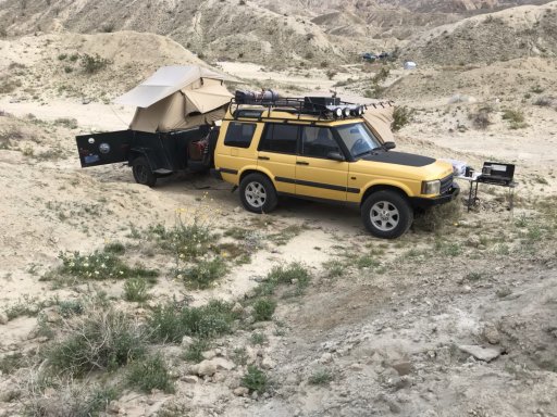

We absolutely love our 2004. We have had it for about five years. I replaced the front joints with serviceable ones. I installed a top hat motor. Soldered the shuttle cable connection to get rid of the 3 amigos. Super comfortable and quiet. If you want a comparison check the towing capacity of the 2004 Disco (7,700 lbs) against other vehicles. Brakes, Axles, everything is well built.IMG_3042.JPG

We absolutely love our 2004. We have had it for about five years. I replaced the front joints with serviceable ones. I installed a top hat motor. Soldered the shuttle cable connection to get rid of the 3 amigos. Super comfortable and quiet. If you want a comparison check the towing capacity of the 2004 Disco (7,700 lbs) against other vehicles. Brakes, Axles, everything is well built.View attachment 89343
Great Rig Mark. I'd like to know more about what you did about the 3 amigo's. I think I may have a problem because a bunch of lights are lit up on my dash panel. The previous owner said not to worry, but I do. Everything seems to work okay but I'd rather be safe than sorry.
