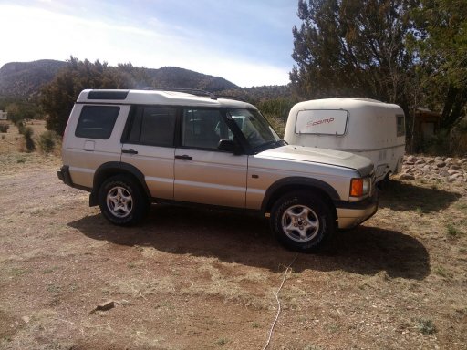

I JUST PURCHASED ONE.. Every vehicle has some quirks. I know many guys who have spent thousands of dollars buy and change out both front and rear differentials on their Jeeps. The same goes for drive shafts, universal joints, radiators etc. I don't know any auto that wont break down when it is not maintained or mistreated. Mine is a 2000 D2 and I am happy to own it. I found another in a wrecking yard in Albuq. last week that could be bought for $1000 or less. The only thing wrong with it was a bum water pump. How many times I have changed water pumps on my Fords, Chivvies, and Dodges. I'm still kicking myself for not buying it for parts if nothing else. Anyone who wants the phone number for it just let me know, before I go back (220 miles) to get it. 88731

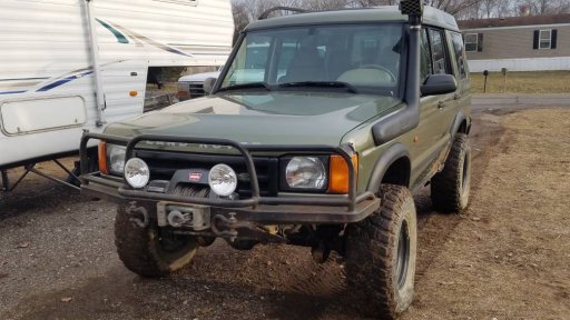

I absolutely love my D2! View attachment 88730
I'm drooling all over it. Did you have the bumper built or is it sold by someone. I designed something similar to it that I plan on having my local welder build. Do you have side rock sliders ? (is there any rocks in Michigan ? ) :blush: I'm planning a 3" lucky8 spring lift kit and some 33" tires, what you think Matt ?
MattAnderson1986
Off-Road Ranger III
3,785
Elkhart County, Indiana, United States
Matt
Anderson
8623
Front bumper is rovertyme aka rte fab I have matching sliders and rear bumper. Lift is a 3 inch with radius arms.
Plan on regearing, I run 4:11s with tru tracs front and rear.
Tires are 285/75/16 I'm due for a set.
Reactions: Arailt
Why did you feel the need for new radius arm's ? Lucky8 told me they are not needed. The 4:11's sound good to me but I wont change that for now. (I don't know what the stock gear is on my LDR2) Is a tru track a locker axel ? Is it air lock or manual automatic operation. I had a 67 Bronco I built years ago that came with 4:10's and Detroit locker from factory. I never changed anything and I went anywhere I wanted and got back home, the name of the game. What year model is your rig ? Have you had any heating problems. I think it is an overblown issue and probably caused by bad maintenance or severe usage as I have stated in other threads. At my age I don't abuse anything knowing that us old folks crack easily...
MattAnderson1986
Off-Road Ranger III
3,785
Matt
Anderson
8623
Radius arms are not necessary but make a difference.
Stock is 3:54?
The 4:11 work well with 33s
Tru tracks are a limited slip not a locker
Ive had my head gaskets replaced but they are actually easy to work on, it's a push rod v8
I have a 2001 4.0
