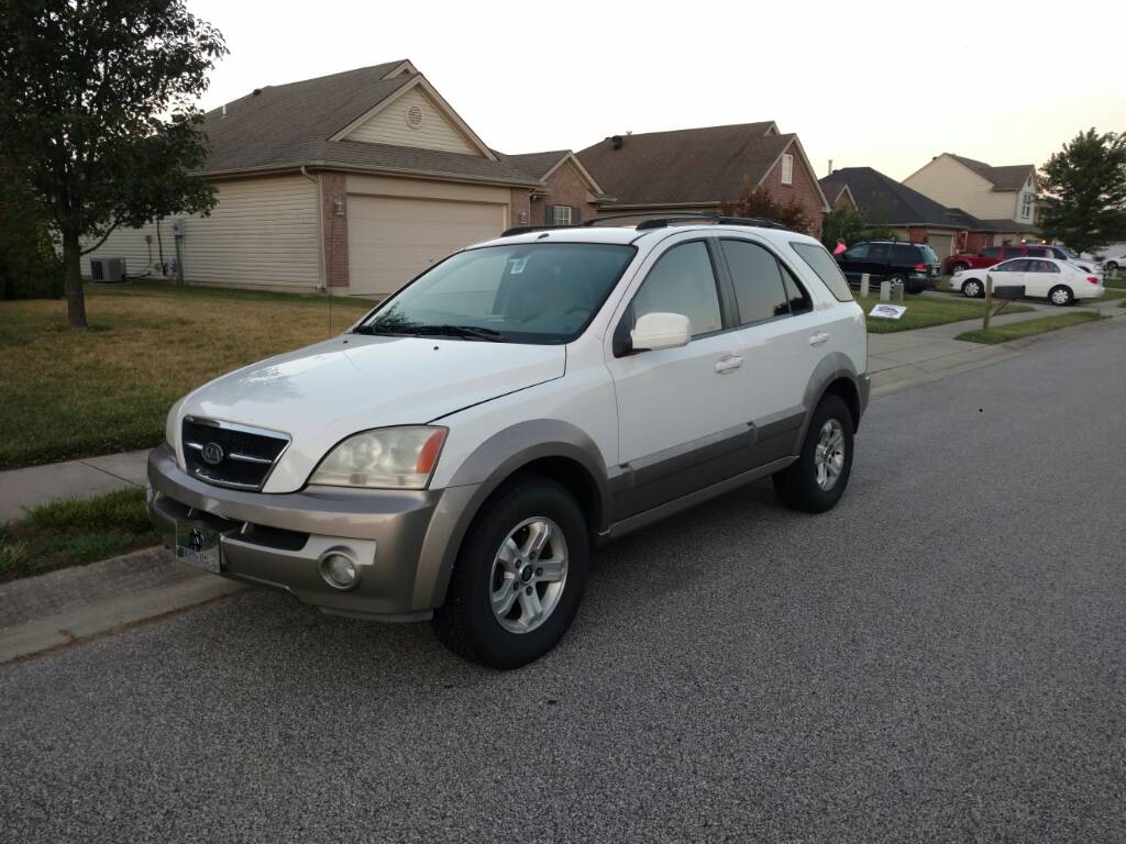

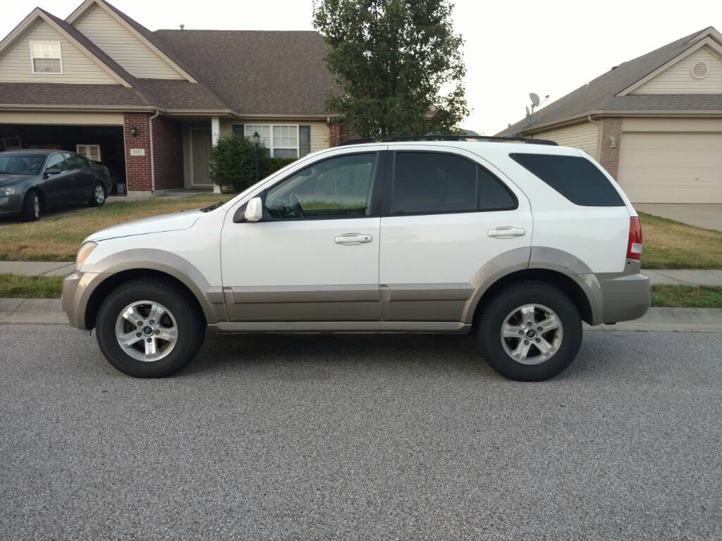

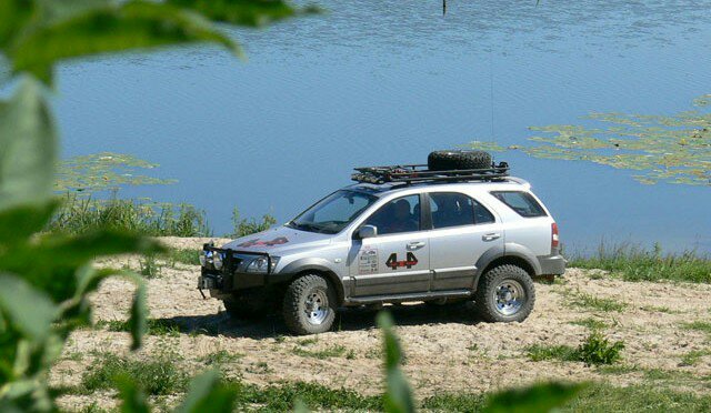

I'm new to overlanding (and the forum). Great topics and tips folks! The rig I am going to work with will be a 2003 Kia Sorento. It is what I have currently to work with. Do any members of the forum have any knowledge and experience with the Kias? There doesn't seem to be a good aftermarket for parts other than old man emu for a suspension upgrade. At least based on my research so far.
Anybody have any tips, hacks, and advice for me. I am planning on getting a different truck in the future but for the time being....

The Old Man Emu lifts seem to have good reviews for the Jeep ones. I would imagine the quality would be good for any.
Good to see we have a variety on here.
Also good to see people aren't falling into the it's not a designated "offroad" vehicle so it can't do anything.
Many people never take there rigs on anything more than dirt roads for camping. As a 2wder I've made mine far more capable for overlanding, whether forestry roads, trails etc don't let it hold you back.
Also don't be discouraged if there isn't that much designed specifically for the Sorento, with a little grinding, welding etc you or a shop could make things work and look great.

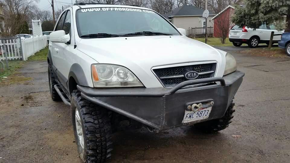

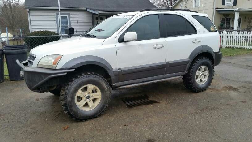

offroadohio
It has the Daystar coil spacers as well as the old man emu medium-duty coil springs and fender trimming to allow clearance of 265 75 16 tires.
Bumper in rock sliders are custom built.
It's basically stock other than that and with the Factory limited slip it will go way more places then even I ever imagined it would go and it is Better Built than any jeep product I have ever owned
Sent from my SAMSUNG-SM-G891A using Tapatalk
