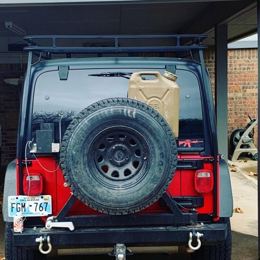

No problem, I had built a mount that you can see in the picture that mounts the can in the drivers side of the spare tire, but I can’t mount one on the passenger side because the can blocks back glass and hits hardtop. So I’m trying to come up with a mount that goes between the body snd the spare as pictured.

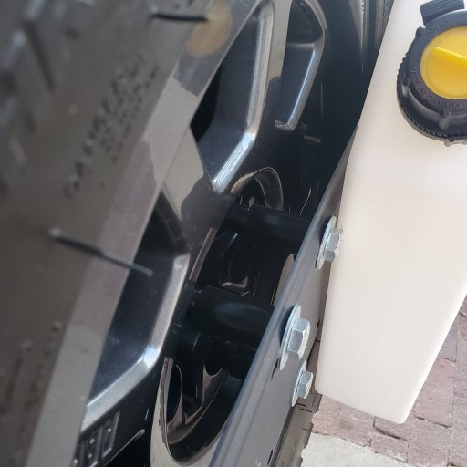

Had them on the roof and was more concerned about spilling up there than weight. I ditched the idea of Jerry cans and went with Rotopax. This has worked out perfectly for me. It is simply a Rotopax mount plate, two RP mounts, two cans. The 3 bolts pass into the hollow lugs of the spare tire mount. I added spacers as well to keep the plate rigid.
View attachment 183944View attachment 183944View attachment 183946

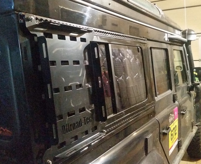

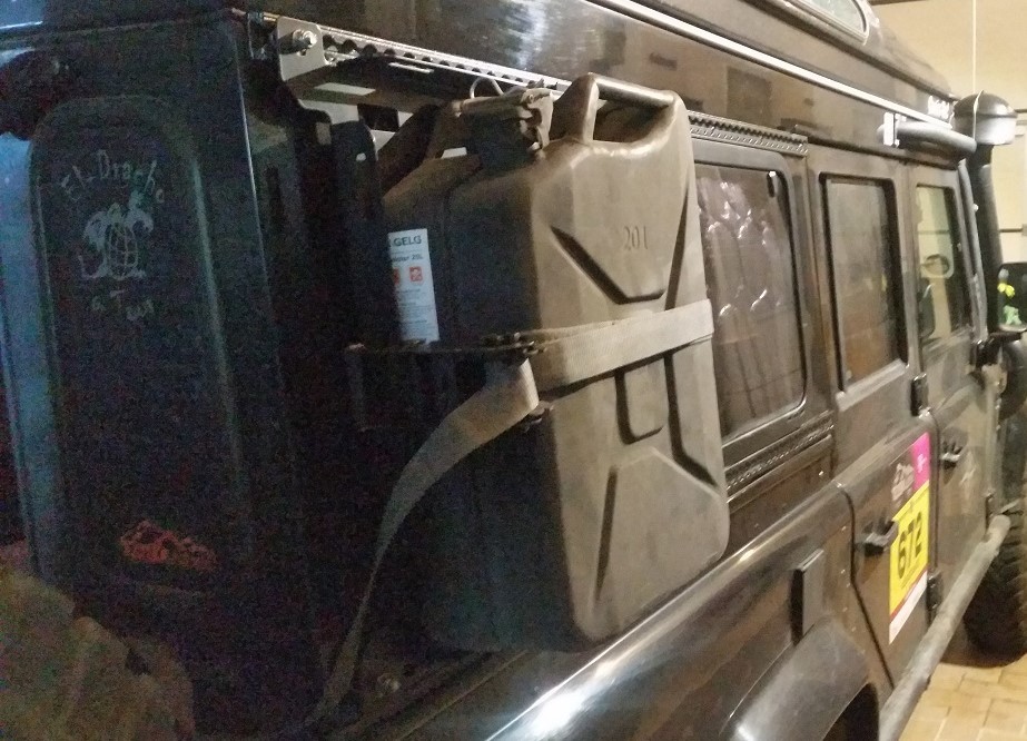

I sometimes carry a jerrycan at the side of the rig. Just mounted airline cargo rails and attached a jerrycan holder there. The mounting position is near the fuel cap, so it is really easy to fill the tank from the jerrycan with a hose. Maybe this solution is adequate for your use case. Will upload some pics later.
