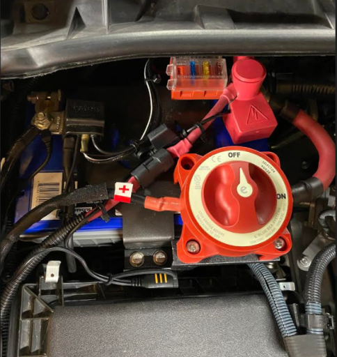

I use a Blue Sea disconnect. There have been some instances of winches continuing to run, its nice to have a quick shutoff located close by. No need to run a dual battery for the winch but upgrading to an AGM might be worth it for longer pulls. I dont know about the 4 Runner but the stock Tacoma battery is pretty weak.
