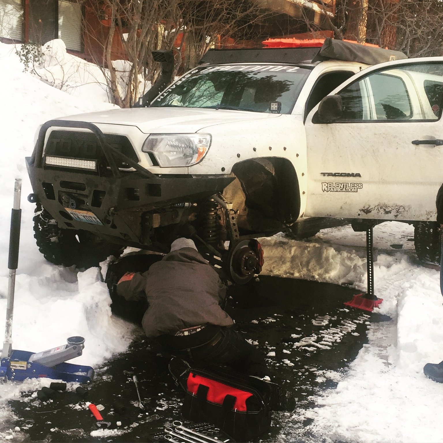

I have used my high lift quite a few times. My advise
- keep it covered or stored in a dry place
- keep it lubed
- try to use a highlift base
- slider adapters make it much safer or bumpers with cutouts
- if you are jacking it up and it doesn't fee stable stop and reset
- Always open the door when highlifting off a slider
- Keep your face away from the handle.
- When you stop jacking under load keep the handle in the upright position.
Practice in your driveway. You don't want the first time you use the jack to be on the trail.
