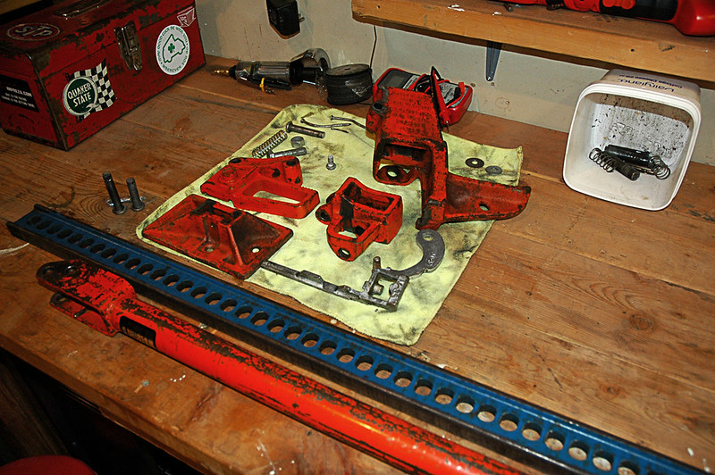

Cleaned up my trusty Jack-all that was passed to me from my Dad back when I got my first 4x4;
I remember his words everytime I get it out; "Stay clear, this jack doesn't care about you."
It lives in the back under the canopy out of the way. There aren't many points on our current truck to use it as a lift, but I've got chains and gear to use it for recovery if I needed to.

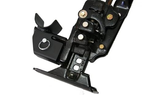

I'm glad to see Ronny's video was posted, it is probably the best video I've seen on Hi-Lift jack use. I strongly recommend using a wheel adapter if you do have to recover. It means the chassis doesn't have to lift as high and the vehicle is more stable.
I've gotten a couple of cool accessories that make using the jack much safer and easier in some situations.
A sand base
A wheel attachment
Handle keeper
Jack Mate
