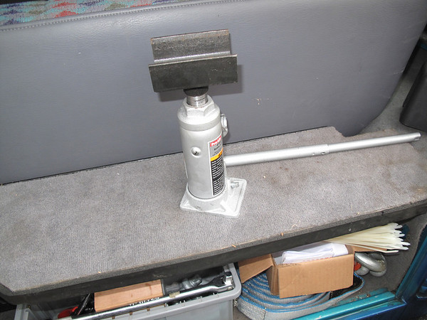

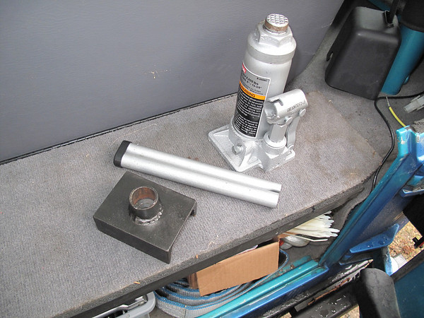

A few years ago we came up with this. A simple bottle jack and a piece of channel it works well on a number of different axle sizes and can help keep the bottle jack from slipping.

That’s great, wish one of those was available commercially. Slippage is my biggest concern with a bottle jack.
I recently had to swap a tire on a rough trail, and used a bottle jack and two jack stands. No problems. I'm nervous about hi-lifts and can't really imagine a situation I'd get into where I'd need one over a basic bottle jack and/or some other recovery solution.
