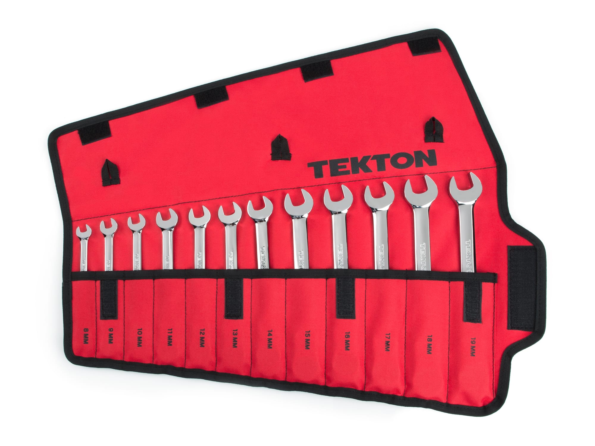

I have had great great luck with Tekton tools...
Here are my thoughts, get this set to cover pretty much everything socket
There are times you need a wrench for access or to hold the other end of something

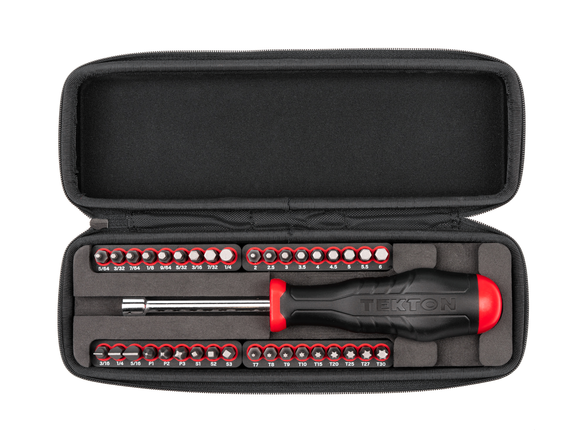

Instead of hex keys get this bit driver set to handle hex, torx and screwdriver needs

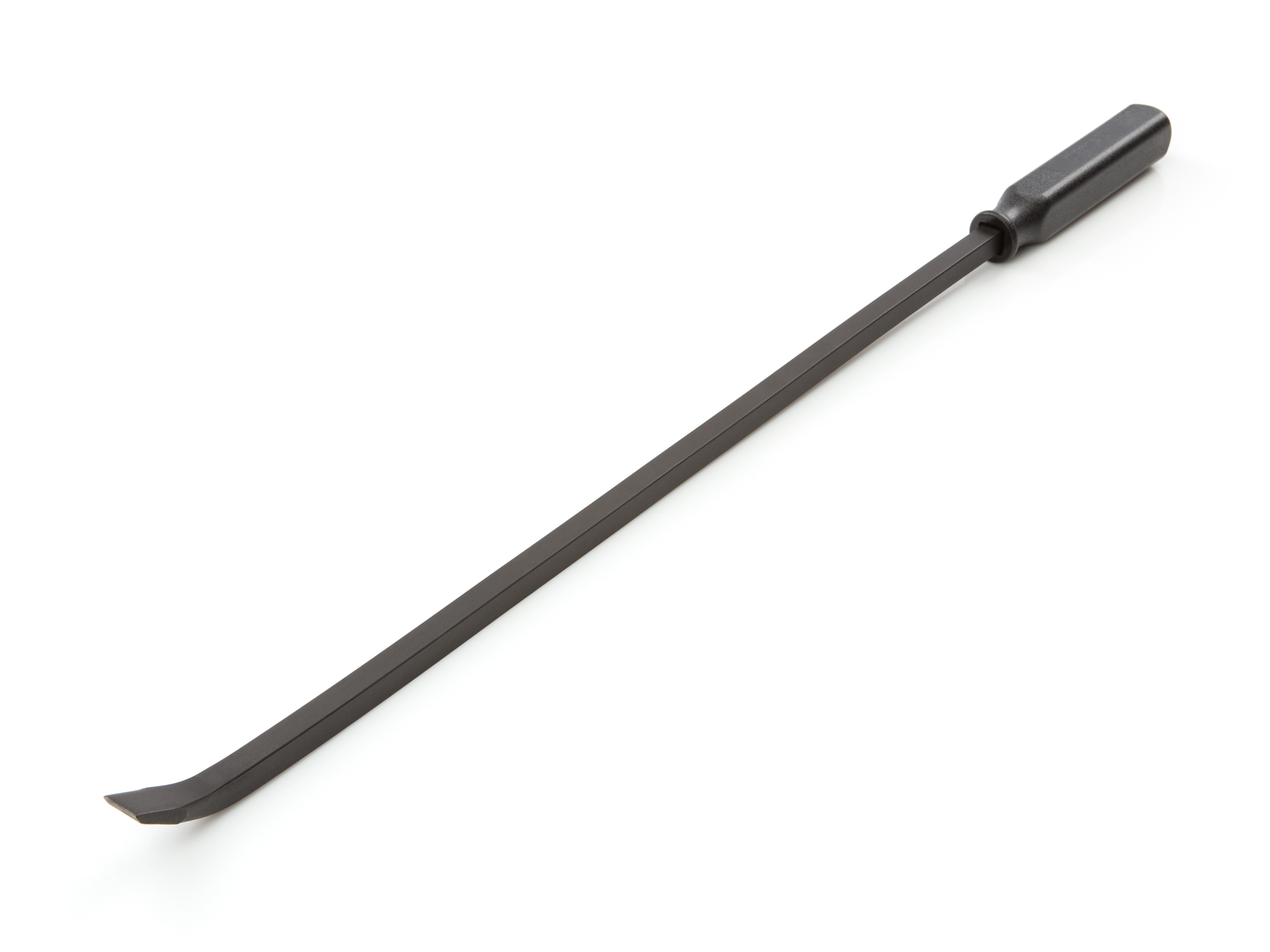

Then get this pry bar for anything bent or a tire change

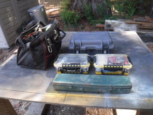

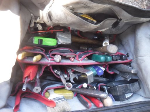

Hi Amanda, glad you made this a thread,
So I admit right off that my viewpoint maybe different than others and it is; Don't take anything you don't know how to use or are not willing to fix on the trail.
I say this because my situation is different, I don't drive a computer driven vehicle, I spent 5 years doing a frame off restoration of my Land Rover. I know it inside and out. I can fix most anything on the trail. Put me in a computerized vehicle and the check engine light comes on and I'm lost.
Series Land Rovers are simple bolt together vehicles of 1940's technology. With that in mind there are places where one might need 2 flat wrenches of the same size to undo, Oh and 1 of them might need to be a stubby. Land Rover has been making mechanics out of men since 1948.
With my resto-mod I put in a newer 1991 engine, it is metric so I need those tools, the rest of the vehicle is SAE with the exception of the transmission, it has quite a few Whitworth nuts/studs. For those I've made do with adjustable wrenches or replaced them where I can with SAE.
Since I want to be able to fix my 109 and not take the yellow taxi I carry quite a substantial repair kit.
1/4-3/8-3/4 socket sets SAE and metric, I find getting the deep sockets covers most of my needs, I got one of those label makers and put the sizes on the socket, much easier to find the right size.
Allen keys- metric and SAE
Various screwdrivers
test lamp, fuses, test jumper leads, jumper cables, wire stripper crimper, electrical tape, wire connectors
Oil filter wrench, tappet tool, compression gauge, alignment bar
I keep all this in tool bags and hard cases, Husky, Nanuk, Plano.

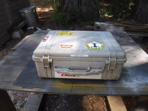

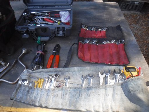

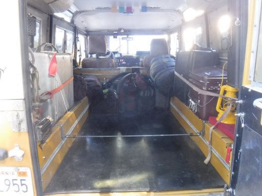

Now for the pics............
How my 109 looks 24/7
Most of it fits in the rear side locker
And yes I carry a variety of spare parts, such as wheel bearings, U joints, gaskets, etc.... Things unique to my vehicle I won't find at the Auto Zone in the middle of nowhere.
Don't forget the gloves, work on the car clothes, grease and oils, paper towels and baby wipes for clean up.
I know lots of stuff, but I'll get home or to help.

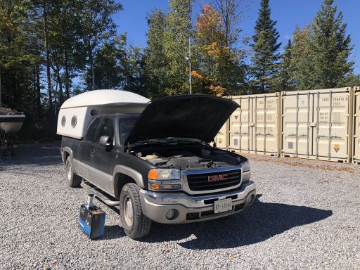

Hopefully no mice and just needs a jump start and maybe fresh fuel. Does Canada use ethanol in the fuel? It can eat away at seals and such. Wishing for the best!
Hi Gene, Thanks for the message, the truck started first time, no mice as it was in a shipping container. I did not know that Ethonel in gas was bad for engines, I also learnt today that when I store the truck for long periods i should add a fuel stabliser. My truck had half a tank of gas in it when stored it, once i have used this up I will add new fuel and a cleaner/additive to clear any gunk out of the engine.
I will look into finding Ethonel Free Gas when travelling, only a handful of gas stations here in Ontario offer ethonol free, fingers crossed the seals are OK, I guess i will know soon if anything major has corroded. Heading out from the hotel now to pick up the craftsmen tool kit and order my tyres.
Heres a picture of the rig straight out of the container!
Amanda,
So glad it started up with no issues! I don't think ethanol is bad per say, just that with some older rubber components it would eat them up. Your GMC is probably new enough not to worry especially after sitting for so long and then running. Good to go! :^)
