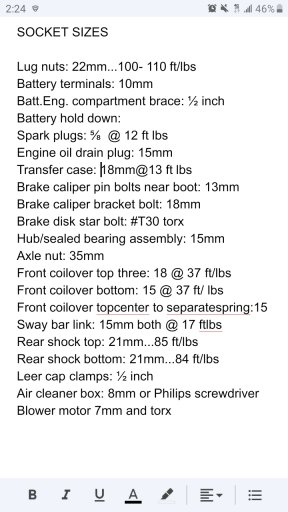

Hi Amanda,
I have an incomplete list of socket sizes, related to thier locations and torque specs, however my list is related to a 2014 GMC Sierra. I'm sure a lot has stayed the same though some may be different

While perhaps some of these will fit, others may not. But here is a short list and maybe it reminds you to bring a socket for "that part" you may have overlooked. Some basics:
Thanks for taking the time, I apprecaite you letting me have this list, I am currently in the UK and flying out to pick up my truck from its shipping container mid september and so I am looking to purchase these from Tekton tools website and have them waiting at a friends house. I am trying to save time by doing this in advance, so fingers crossed I can hit the open road and trails pretty quick. the reason I posted on the forum is that I could not find a definitive list on the internet or from GM as to which tools you need for maintance, i did not want to waste money on tools I dont need or turn my garage(rear seat delete) into a mobile SnapOn truck! The whole metric or imperial thing aswell was slightly worrying, what if I bought the wrong things. Thanks again for the time taken to read and reply to my post - Best wishes Amanda
That's the list I made for my truck. 2014. Yours may be different t but probably very similar. I scoured a few forums and had some trial and error many years ago for that. You should check those against your truck.
