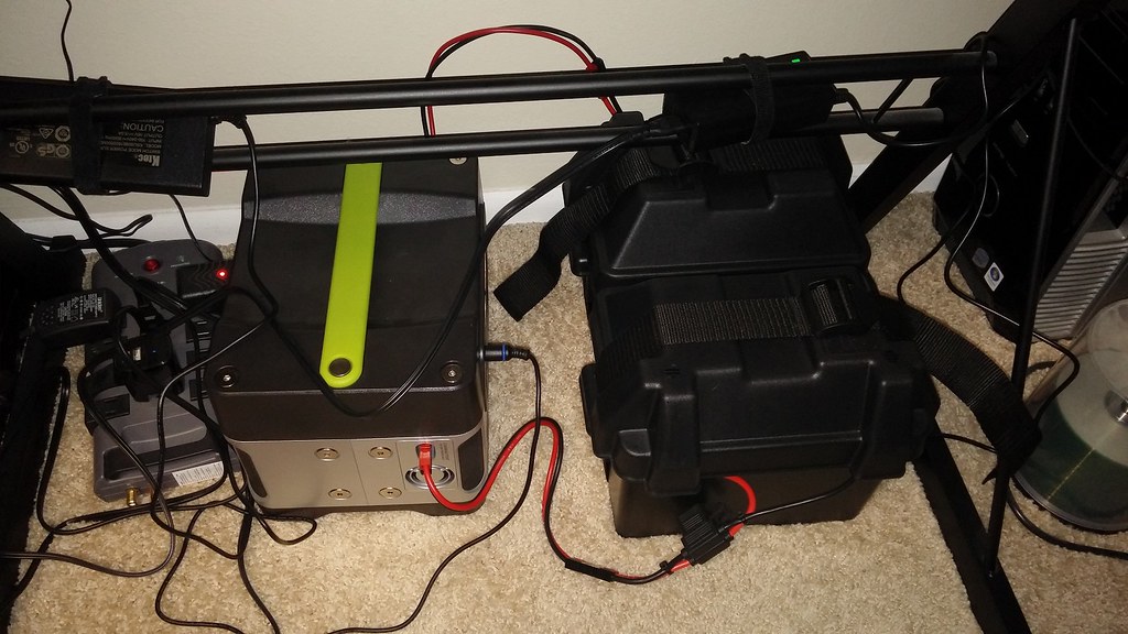

I got bored running this stuff on the 2 batteries after 12 hours and the batteries still holding @ 12V ! I am amazed and elated that I can get that much run time without the panel even online (as would be after dark). Our needs for power will never exceed what I have seen from this setup. Now I need to figure out how I want to fit this into my jeep whether it is an all in one tote setup , or split it into battery box and power panel. Thinking a tote so I can just load it up and go without having to connect it up each time. Decisions, decisions and weight is the biggest factor. A tote with all will be hell on the back...lol

They sold me a yeto 400LI for $300 as a "first time build" the only thing I found different on it was a missing USB port. Hell yes I took it, the only thing I hate.. Li batteries have a voltage of 10.8V, not 12V. So with DC the fridges freak out and go offline for low voltage and for good reason, but I still want a 1400 just for home preparedness as I am a prepared freak, but I do like my 400li and 400 AGM. I personally would take AGM over LI for several reasons (cost, daisy chain, etc). Under my desk I have the 400 AGM and 2 extra 33AH batteries that I use all the dam time. I have ran my camp chef pellet smoker for 6 hours and still had 100% showing, meaning I could use it for cooking if needed, but I would rather use my propane and white gas options first, then dutch ovens second, then grill last. But with 260lbs of pellet, 400lbs of charcoal, 160lbs of propane and 10 gallons of white gas, and last using the solar oven since it takes so long. Im not worried of preparing food during a disaster/ zombie outbreak.
