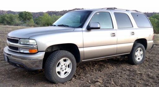

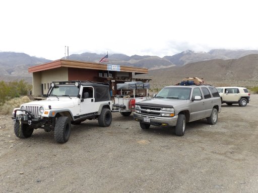

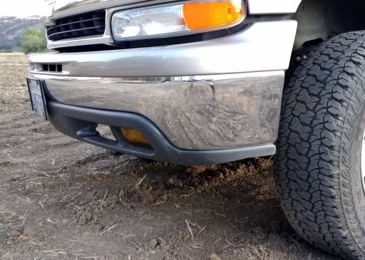

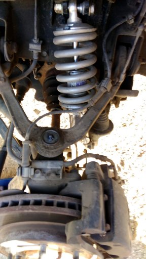

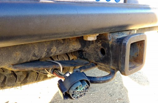

Previous full size rigs include a 76 Blazer, 76 Cherokee, 99 Silverado, and 2003 Silverado. All have been daily drivers and "hunting rigs" spending a lot of time in the national forests hunting and camping. Currently my daily driver/family adventurer is a 2001 Tahoe. I bought it used with about 117k on it. Included were the G80 locker, full skid plate package, and front tow hooks, so I had something to work with. The mods made are as follows: Replaced 20 inch rims with factory 17s and 265-75 all terrains, replaced front torsion bar setup with coil overs from Atomic Fabrication, removed air ride/autolevel system and replaced rear springs with heavy duty coils and Bilstein shocks, removed plastic running boards, and after dragging the stock hitch receiver, cut it up and put it back together with the receiver 3 1/2 inches higher and hugging the bottom of the bumper, and trimmed the front plastic air dam up about 2 inches.

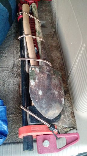

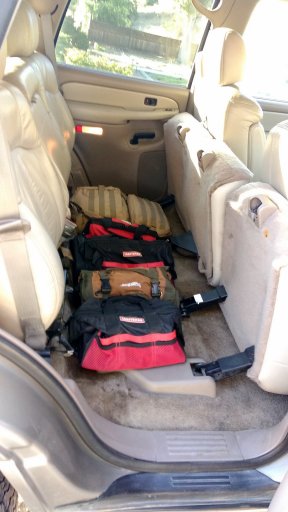

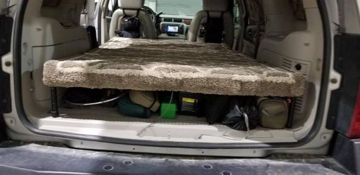

The height sits about like a cranked up Z71 truck from the same vintage, but with the coil overs in the front it rides like a Tahoe should. The vehicle is very capable. For example, in 2018 with full load for a 10 day trip, it made it up Goler Wash and Mengel Pass no problem. It is pretty good to go, other than I wish someone made rock sliders for it and I need to fab a front radiator skid. I enjoy all the room. My tools, air pump, recovery gear, etc fits under the rear seats and with the third row seat mounts I can secure gear easily and secure my high lift with J hooks.

Switching the torsion bars in front, especially if they are keyed and cranked, for adjustable coil overs in front and Billstien 5100's in back made all the difference in my Tahoe. Also airing down to about 22 psi (lower if you can give up the ground clearance) drastically helps. Serious miles of Death Valley washboard on a 10 day trip were no issue in the Tahoe. All others on the trip were so happy to make camp ever day and get out of Their Jeeps. I'd just loosen up or stiffen up the fronts depending on the terrain that day.
