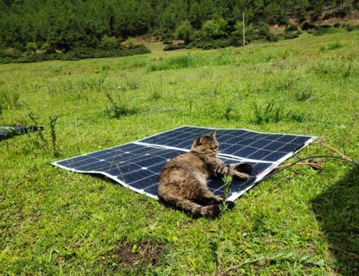

Daughter gave me a Topsolar 100W foldable solar panel for Christmas to provide the solar charging. Definite an upgrade to my little 40W panels I was using.
