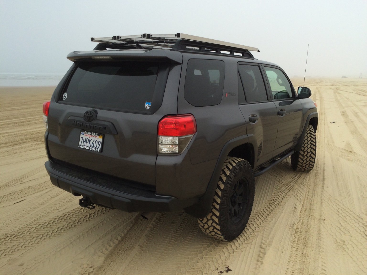

Those "mounting points" in @BEAR's picture are just plain scary!

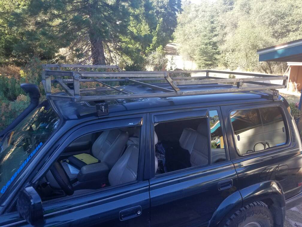

Mine was actually built using 1in EMT tubing lol... It is super light and surprisingly strong, I was standing on it and it didnt even flex, and I weigh 210.

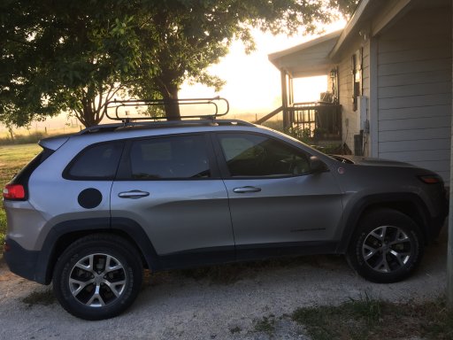

A basket I did for my YJ years ago using 1/2 EMT. It sat on a Smittybilt rack. Once I received the Smittybilt rack I couldn't bring myself to pay for there basket. The rack was not all that well built and I could have made it for half the price. P1010072.JPG

A basket I did for my YJ years ago using 1/2 EMT. It sat on a Smittybilt rack. Once I received the Smittybilt rack I couldn't bring myself to pay for there basket. The rack was not all that well built and I could have made it for half the price. View attachment 6102

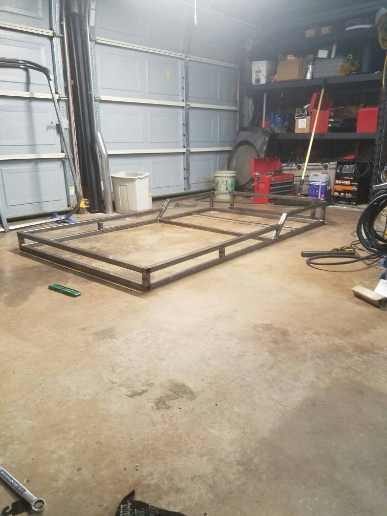

Looks great! I finally started on mine, this is just the beginning I'm planning on taking up the entire roof.
