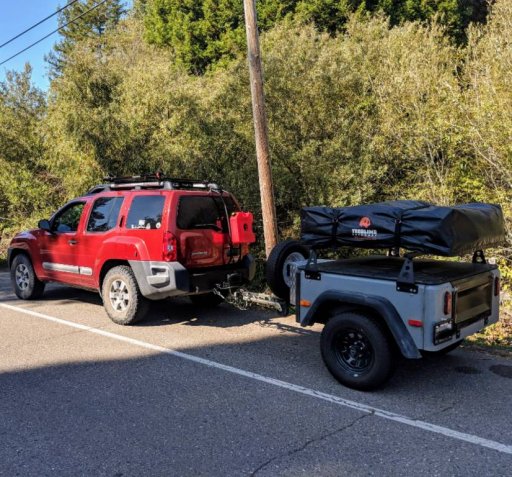

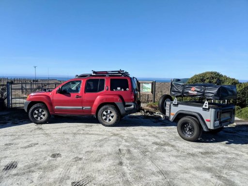

I am very happy with my compact j frame. I am getting ready to install an electrical/solar set up in the tongue box this weekend.
