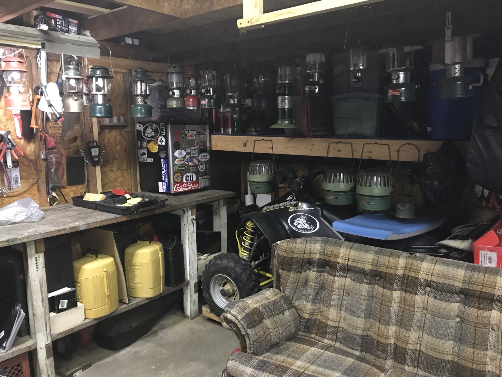

I thought I'd add to this and bump it up for other addicts. The sickness is growing, I'm up to 7 lanterns and 4 stoves, and looking to aquire 3-5 more lanterns this weekend.... :anguished:
I'm working on a late 50's KampLite that probably won't do much camping, but will get run around the house with my 59 228E. I'm also looking to get a couple 200's and convert one to kerosene just to play with.

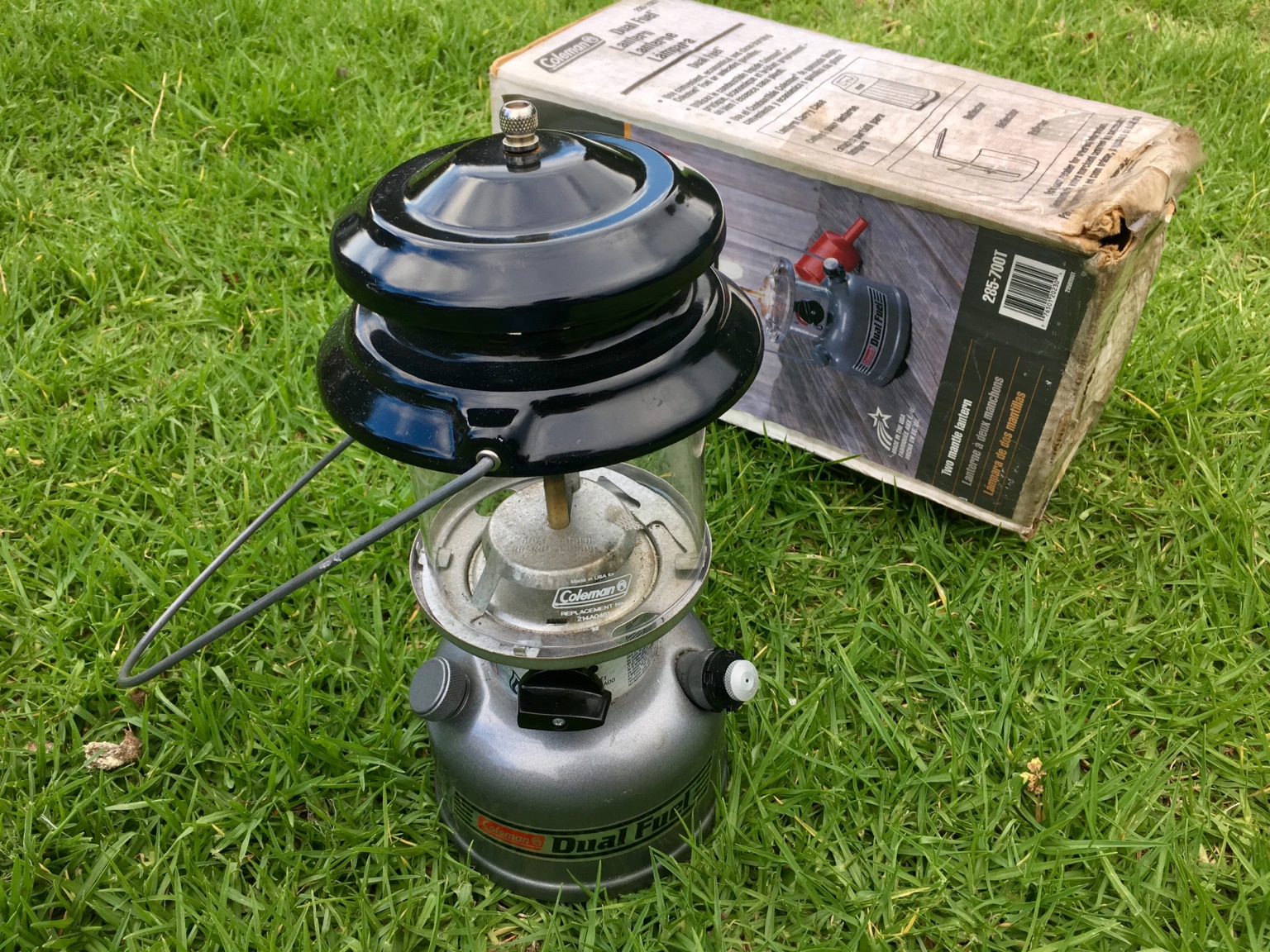

Stamped August 1999, 285-700t
Need a carry case terribly, the old box is mouldy and soft.
Will pick up a couple of mantles tomorrow and light her up as she arrived without, pumped and lit ok though
My beater is a 288a, the non-dualfuel version of that. I did read the other day that some of the 285s were designed to run on E10 gas as well as regular unleaded. You can do a kerosene conversion on that family of lantern pretty easy it seems. Just swap on a 288 genny as they are slightly undersized for the two mantle lanterns and add a preheater cup.
