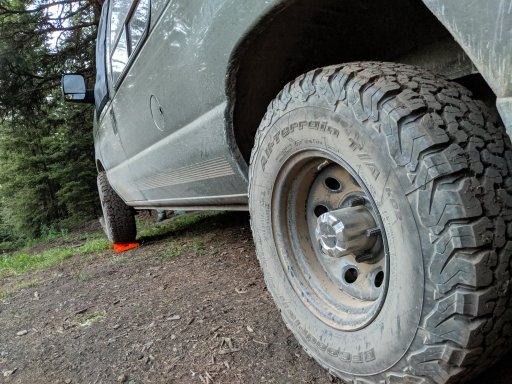

While I have ran the previous BFG AT's on older rigs, I just put my first set of KO2's on the van I bought in May. We did a 2,300 mile trip around SW Colorado last month, with a couple hundred on dirt / gravel, and they have held up well. I also had no traction issues, whatsoever. Of course, I got the cookie cutters, and am not far below the weight capacity of these, so those both help. I have a feeling they won't last as long on my rig, due to the weight, though I really don't expect to have them on more than 6 more months, or so, since I plan to do the 4x4 conversion and move to at least 33's, likely 35's.
