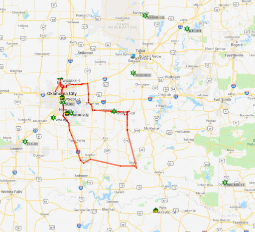

My APRS radio ran for 6 days straight while I was on a 450 mile round trip this last weekend/week and there are obvious holes in coverage in the SE part of the state.
The packets that did make it were long haul packets hitting digi's 115-160 miles away in Arkansas or NE Oklahoma.
What path setting(s) were/are you using in that part of the country?

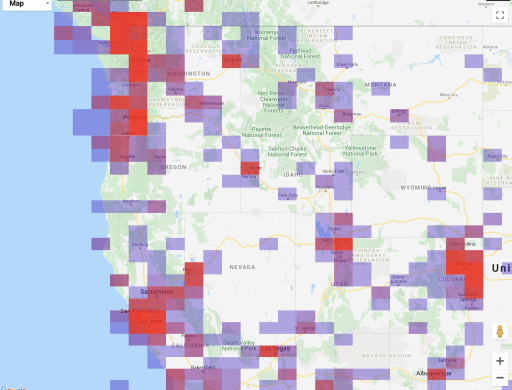

As remote and mountainous as we can get here in the PNW - the Rockies of Montana, S Eastern OR, Wyoming, Nevada, etc. As a technician I am limited to 2 meter APRS and that drops off once you leave the black top. A buddy got his General last weekend (in Redmond WA) and is pushing me towards HF. Maybe HF APRS is the motivation that I need!
I am a 2 meter APRS fanatic, just looking for something to communicate from that high mountain valley. And so far iridium is it. HF APRS sounds interesting though!
Here are some spots that are "APRS deaf" and also make for good overlanding.
47.10082, -112.47989
42.25071, -118.17840
41.75407, -118.75193
41.30160, -116.85448
39.39804, -117.03883
The aprs.fi "heat map" (zoomed out) shows that the places my cadre goes have little to no APRS coverage.

APRS is never deaf, it simply is out of reach of an igate at times. The fact is that the mode operates completely independently of the internet.
Ubiety
5,221
Sammamish, WA, USA
Greg
Ubiety
6193
Ribs
I simply meant to say that APRS is deaf if there is nobody to receive it; maybe a poor choice of words. I believe that the scenario that most folks are interested in, myself included, is the ability to "phone home" with a message or beacon while overlanding. If you can't hit a digi/igate but you can hit a rancher's unmonitored radio have you achieved that goal? For me, the fusion of RF and making it accessible via igating is what makes APRS compelling. My non-ham-non-tech wife can click on a link and (hopefully) see my latest status.
I think your point was that APRS is not deaf because intra vehicle (non-internet) comm via APRS is possible. This is actually the subject that has drawn me back into APRS. I have become accustomed to navigating with an ipad and want to add APRS to that to allow additional comm opportunities for the convoy - not necessarily to get out to the rest of the world - but to enhance the convoy's ability to operate as efficiently as possible.
