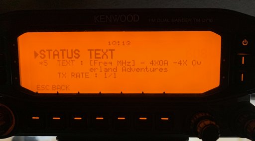

So I've got my TM-D710G going and it's working out pretty good. I'm having some issues with the QSY setup though. When I set it to encode the QSY into the message itself, I can't get a good position packet passed to show in aprs.fi and there isn't anyone locally who uses APRS to know if my packets are good and would work or not. It works fine with the built in QSY turned off though. But again I need someone locally to figure out if it works if I build the QSY data into my message instead of using the built in setup.
Otherwise I'm loving the Kenwood. It's a great radio and I'm happy I went with it.

You could put the QSY freq into your beacon message.
That's what I'm going to do but I had hoped it would do it automatically so I wouldn't have to edit the message when I changed frequency while driving. I monitor 520 when I'm not at an OB event and the local simplex frequency of 147.555 when I'm around town.
You can do this in the radio settings I will try to find a screen shot.
Go into the settings, APRS - Status Text it' screen 608 I believe. Where you see TEXT: add [Freq MHz]
For Example:
TEXT: [Freq MHz] - OB Member 1234
TX RATE: 1/1
Good luck... We use it all the time. Especially if someone reaches a designated camping spot before others. It is nice for them to see how far away we are.
Here I am on APRS.FI, Station info for K1LDR-9 – Google Maps APRS You can see the stand by frequency I was on in the comment section. As that changes on my radio the message will change.View attachment 93828

I have a couple TMD700a's and don't see that they support this functionality - but they might. :) If I remember will give a try later in the day when I get home to see what I can see.
@1Louder - point of clarification. Your raw APRS data shows no space between the frequency and the - (dash) but your screenshot above looks like there is one in there. Does the space between the freq and the dash exist in the radio setting and get stripped out somewhere? Also I assume that "[Freq MHz]" is a placeholder for something like "146.535MHz" or does the radio replace "146.535MHz" with your non-data band current freq?

I got my 710 doing the QSY automatically with the setting in the radio where it adds frequency, tone and offset itself from for voice channel. I'm not in a great coverage area at the house so I had to drift around some to find a good spot to play with the setup.
You'll have to check the manual on your 700 as I'm not sure what features changed between the two. If you enter [Freq MHz] in the 710 it will enter the frequency from the non- data side of the radio. There are other commands to enter the tone and offset as well but the QSY setting will do it automatically.
Thanks! Searched the TM-D700 manual and found no mention of the QSY feature but did see a few things on the internet that indicated it would work.
That was the answer that I was hoping for - makes it a lot more automated/nicer. I'll give it a whirl on my 700s when I get home and see what I can learn. Cool feature!
