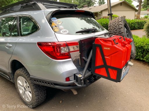

Lookin g pretty good out back, pick it up Friday. Haven't seen the work on the front bumper yet and the rear will have a drop down table behind the gas cans. Built by Stellar Built in Sacramento, CA.
This looks amazing! I hope to fabricate something similar for my Forester soon.

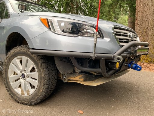

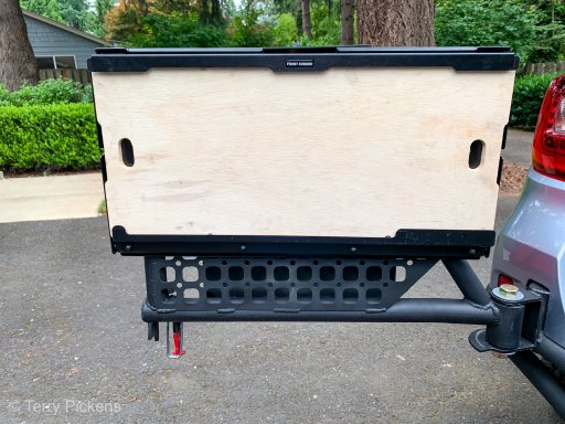

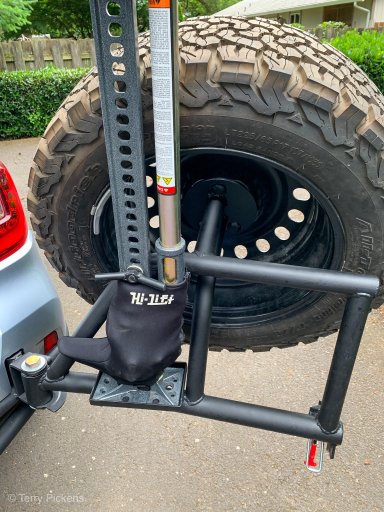

OK, got it back home and I must say Stellar did some fine work on these bumpers. Well triangulated and the tow points are braced straight back into the mounting points on the body. Dual swing rear carrier is solid and when you try to move the tire it moves the whole car. I'm very satisfied with the work they did on this custom bumper. Now I must massage the front skid plate so it won't grade the trail.

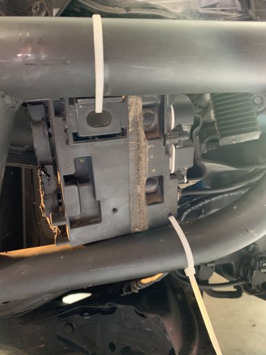

One thing I did notice when I had the front bumper installed was that the car kept throwing a code. Check Engine Light was on, Cruise Control And X-mode indicator lights on dash were flashing. Did some investigation and found that the Active Grille Shutter was the culprit. The motor was electrically connected but not installed to the shutter mechanism. We believed the motor was over rotating and kept throwing the code. My son and I took the Dremel and cut down the active grille and reinstalled the motor. We then mounted it back behind the license plate. Well low and behold the code cleared and has been fine since. So a word of warning the computer of this vehicle keeps track of all that we take off and doesn't like it removed. Simple fix once we discovered this and just wanted to pass on the info. Also want to thank another member and Subaru owner, @Liana Lehua for her help in this.

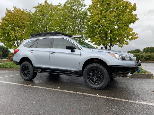

After my adventure to Tuktoyaktuk, NWT, Canada up the Dempster the tires were very tired (pun intended). So I ordered new wheels and tires. KMC wheels with 38mm offset and 245-65?17Fallen Wildpeak AT's.
View attachment 118662View attachment 118661
Most Subaru bumper deletes don't look that great and just look like the car is missing a bumper. However this rig looks amazing without the stock bumpers! Job well done and I'm sure you're loving that extra bit of approach angle you got!
