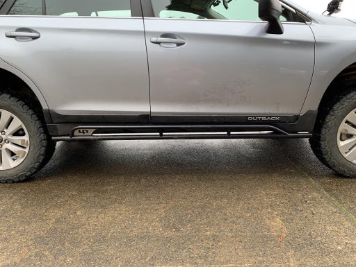

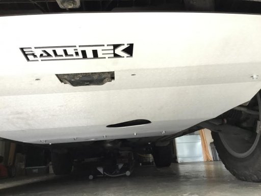

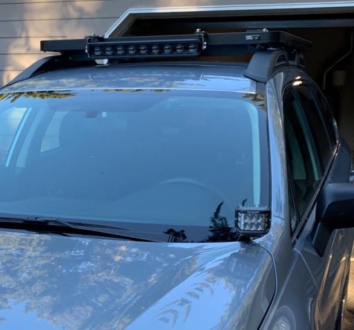

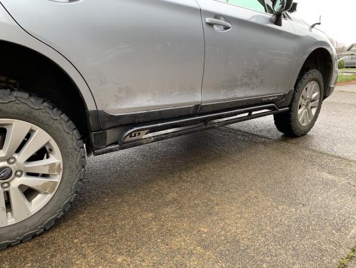

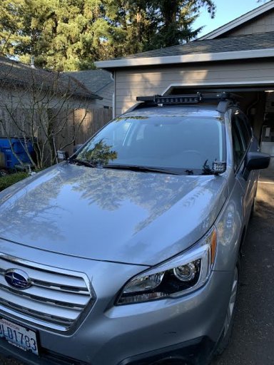

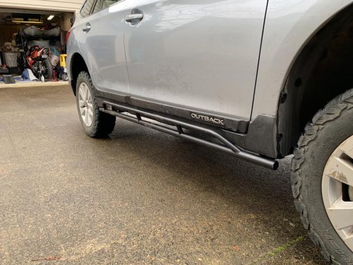

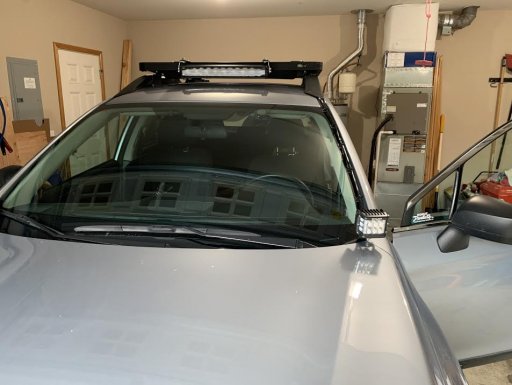

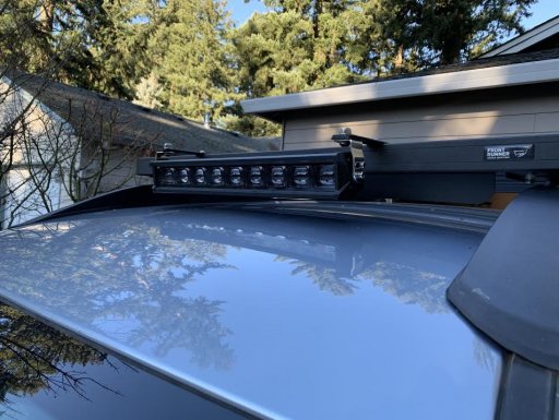

OK everyone here are the latest additions to my Outback. Got some LP Adventure Sliders, RalliTek Skid Plates and Element LED lighting.
0-4.jpg 0-3.jpg 0-5.jpg Skid Plates.jpg Lights01.jpg lights04.jpg Lights02.jpg Lights 04.jpg The Sliders went on really easily, the only problem I had was with the Muti-Link spacer. I called LP and they sent me their spacer that fit in perfectly.
The skid plates bolted up great, the longest part was taking off the stock plastic and all the clips they have to hold it on.
The Element LED lights were great, I got the ADF Ditch Mount brackets and everything bolted up perfect. The 10" Light Bar was mounted on the Front Runner rack and I made some brackets to hold them under my RTT.

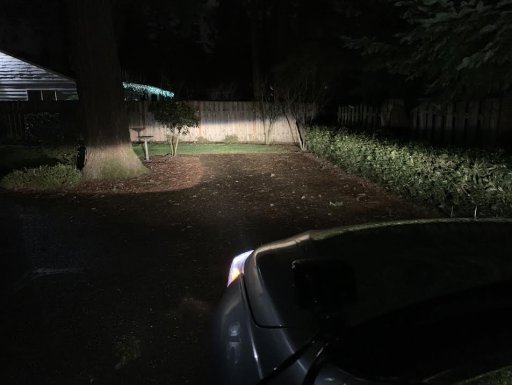

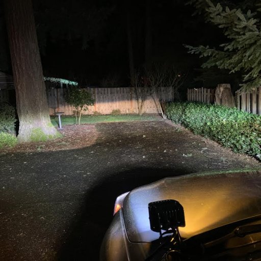

Here are how the lights perform, taken at night in my driveway. I'm quite happy with them and will adjust the lights when I get out in the dark hills on the trail.
First is stock low beams
Second is low beams with ditch lights
Third is low beams, ditch lights and light bar
Forth is high beams, ditch lights and light bar.

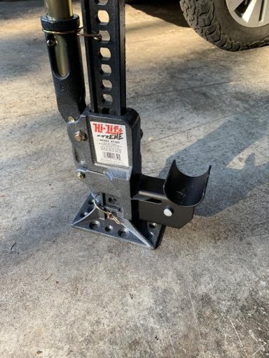

Same here. Patiently waiting for pictures of it up on a hi-lift jack.
Just got the slider attachment for the high lift and will be trying it out soon. If you all want photos of the attachment points underneath let me know and I'll post them up.

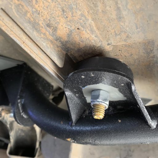

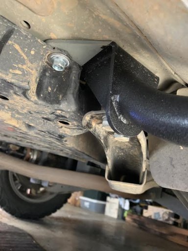

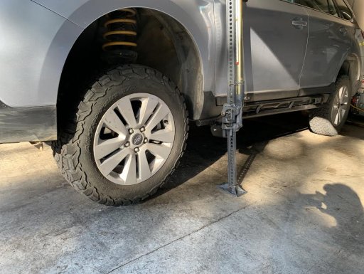

Here are some photos of the slider attachments. All required bolts are provided. Easy install.
1. Hi-Lift Attachment
2. Front wheel raised about 1/2" off floor
3.Front mounting attachment (notice the hockey puck protection for the uni-body
4. Rear mounting point (notice another hockey puck)
5. Close up of rear mounting point
6. close up of rear hockey puck
The hockey pucks are hard rubber.

i put them on mine too recently, am not sure how I feel about the hockey pucks as you call them taking impact and the load on the (I am not sure if thats just body metal above or what)
I am not sure I am brave enough to jack with a high lift lol.
I've been meaning to take off my valances to see what's under it.

I'm actually hoping I dont' have to find out. I did raise the car with the Hi-Lift at the front mounting point, the one with the most leverage and it did not damage anything.
