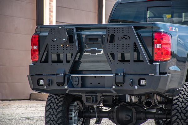

Do you know the brand? Might save me some time googling. The other concern is how far the tire sticks out behind the truck cause issues swinging out the tire to drop the tailgate if the trailer is hooked up. It could also be a problem making tight turns and the front of the trailer hits the spare tire.
This seems like the best way for my needs, but I’m just trying to cover all the bases.
I use the Wilco brand.
From their website they say -The Hitchgate Solo line is tow-rated at 7,500 lbs (max trailer weight) and 750 lbs (tongue weight). *These limits may be more than your vehicle’s capacity. ALWAYS stay within the limits of your vehicles tow/tongue ratings)*

For my Ram 1500 I reached out to Expedition One. They said they’d have a version of their dual swing out rear bumper in the next couple of weeks. A little pricey, but the 2500 version will hold a 40” spare and 4 roto packs or 2 nato scepter cans.
I just looked at this swingout bumper. Really nice. Your right though, pricey.
They are really nice bumpers, and they appear to be pretty beefy. But, wow, that is an expensive bumper.
Exp1 is my first choice with the Denali Package for my Ram 1500, I also like Wilco Offroad's Tailgate options as well.
