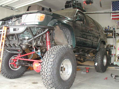

No kidding on the weight. I used to have 37" MTR tires on my '99 4Runner.
Those things are heavy. I can't imaging trying to get one of those off the roof of a vehicle. Not to mention, having that much weight up high, throws off your ability to side walk any trails. Actually any weight up high is no bueno for trail running.
