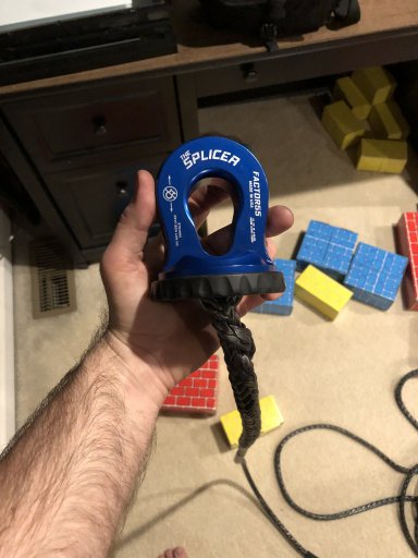

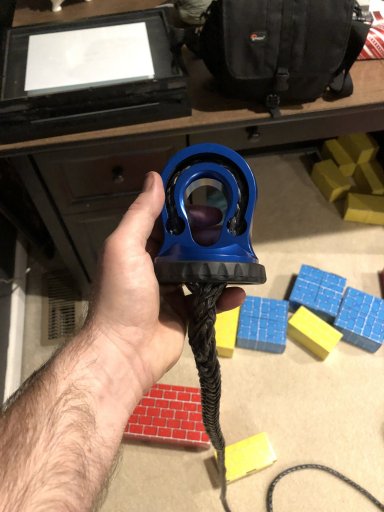

The thimble is a Factor 55 Splicer. I unspooled all the line and spliced a proper locked brummel.
View attachment 131901View attachment 131902
Nice splicing, i can garauntee mine would look like trash. Best id get would be a lindeman knot or shark knot. Wife and i are in kentucky headed toward greenwood indy area right now just stopped for some food.

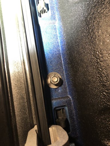

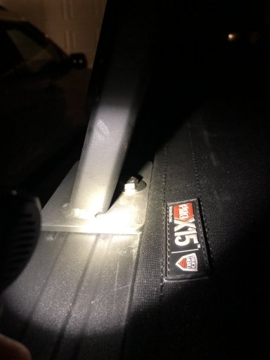

Also, in case someone asks, the rack, which I designed to my needs and had made, bolts THROUGH the bed rail. I had no desire to dick with trimming the tonneau rails so I just designed the rack to have the bolts run through holes on the inside of the legs. Sorry it was dark when I happened to grab these. Yea drilling 6 holes through the bed rail on a $45k truck may bother some, but this truck will be mine until it dies.
View attachment 139631View attachment 139632
