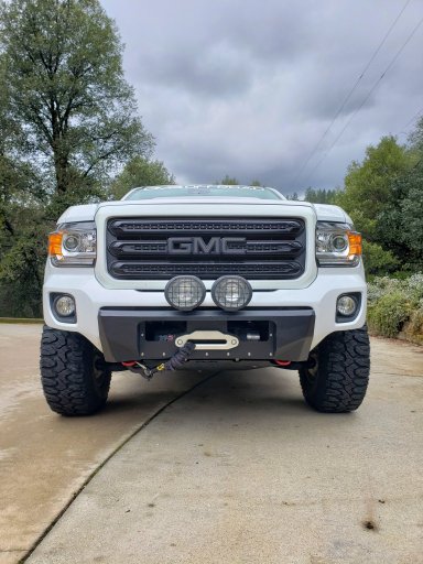

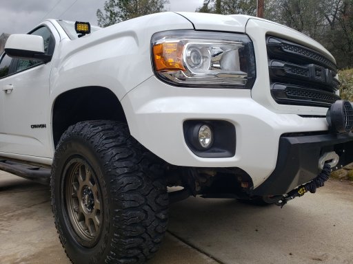

I can't afford a new front bumper and there are currently no options out there that I like so......
Chop chop chop. :)

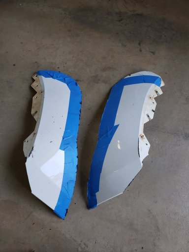

I freehand cut the lower valance to give me a bit more clearance off-road. I originally planned to reuse the "waffle" by relocating it higher up but I'm not quite ready for that much work. So for now I just tucked the felt liner up into the wheel well and tacked it down with a few of the original screws. The next step is to buy some automotive edge trim to clean up the cut edges. I messed up the cut on the driver's side so I'll need to trim that about 1/2" higher near the wheelbut for now it looks decent.
After
Before
That looks great. An approachable and tastefully executed mod, low cost, with a huge benefit to your approach angle. That's a win if ever I saw one! Nice work!
Reactions: JCWages
The angles are kindof wrong too, yours is straight in the center while mine kicks out.
Well damn. For some reason I thought they were more similar. Midwest and DV8 need to come out with bolt on "wings" that you can add to their stealth bumpers for folks who want to change things up or buy in stages.
In hindsight I should have made a template out of card stock but I couldn't figure out how to make it work. I am going to carry the cut just a little higher up into the wheel well to smooth out the angle a bit then apply the edge trim. That will round everything off and protect the paint.
