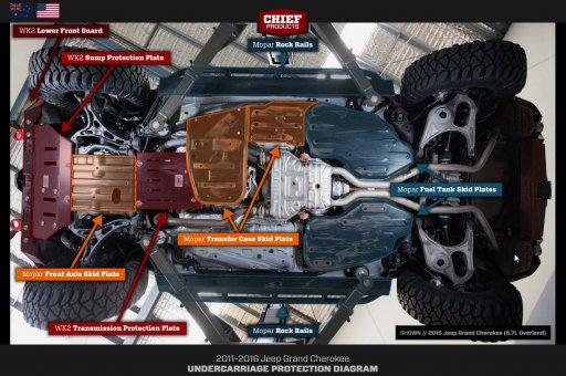

Welcome to the Ecodiesel club! I have a 2015 Summit and I love it. Since yours is an Overland model with Quadra Drive, it "should" have all the skid plates. If not, that is definitely something to acquire. The OEM skidplates are good quality stuff and should run you around $400.
I don't know if you have heard of them yet, but Chief Products from Australia makes really nice stuff for the WK2, and is available in the US.
I have their sump and transmission protection plates, as well as their lower front guard. Since the summit did not come with OEM Tow hooks, I got those too.
Then, since you have the diesel, I would definitely get a DEF harness and injector protection plate. I had my harness snag on something and my car immediately went into limp mode.
I have the shieldproductions one and really like it. The company is sometimes slow to respond, but I have always received my stuff.
