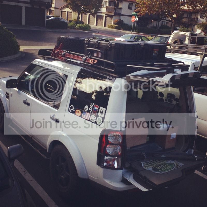

Roof racks... This is another huge topic of discussion for the LR4/Discovery 4.
I know I posted photos of the early build of my LR4 with Urban Offroad rack, but here are more details about my journey with roof racks.
My current build has a standard basket Baja Rack, but this is my third rack and I will detail why I eventually chose the Baja Rack. On my 2011 LR4, I had a half-rack, which was a Voyager Rack and before the Baja Rack on my 2013, I had a full Urban Offroad (not sure if they are still around, no website right now?) rack. I liked the Voyager rack, it had a great fit and was well made, but I just had a hard time fitting all of my stuff properly. I ended up leaving it on my 2011 LR4 when I traded it in and then bought the Urban Offroad rack for the 2013 LR4. I initially went with the Urban Offroad rack on my 2013 LR4 because it was a relatively local company in CA, the owner Derek seemed to take a lot of pride in his work, it fit with my stock full-length roof rails (came with the black design package), and he installed it for free. At the time, I also bought the OEM rear ladder and his rock sliders with side steps, but rock sliders are another post for another day. I plan to do an entire post on rock sliders and overall skid plate protection.
Why did I switch to Baja Rack from the full-length Urban Offroad, well for a few reasons. The main reason was just the use of space, ability to mount side brackets, wind noise (there was no real wind fairing and it sounded like a jet engine flying above my rover), and the rack flooring sat very close to my roof top glass (the roof of the LR4 is all glass. I also did not care for the fact that there was nothing in the front part of the rack over the sunroof. Sure, I know there needs to be room to accommodate it opening, but all the other racks had a flooring in that area.
Here is a photo of the Urban Offroad rack when I removed it from my LR4. The weird wind fairings actually worked a bit better than other ones I tried, but I decided to give up since I knew I was getting the Baja Rack.
I looked at a few Baja Racks on other rovers in my local Land Rover club and I really liked the design/look and overall usefulness of space. After some consideration, I ordered the Baja Rack with shovel, Hi Lift jack, and jerry can mount. Looking back, I would skip the latter, as the nice thing about the Baja Rack is that it has built in holders for 2 jerry cans in the rear. The additional 2 jerry can holder bracket is nice, but it takes up way too much space. I guess if you were doing a long distance journey and really needed fuel, it would be great. Not to divert from the topic of roof racks, but I also bought a long-range fuel tank from Australia (before Outback Proven in NV closed their doors), but ended up giving it to @BEAR since I was going to move. It would be really cool if you were doing long-distance trips since the range in the LR4 is terrible. They have a much smaller gas tank to save weight. Bleh.
Now back to roof racks. The one thing about the Baja Rack is that it is made for an LR4 without roof rails or half rails, they stated that it would not work with full-length rails like I have on the LR4 with black-design package. Despite this, I was going to make it work, even it meant removing the full-length rails.
Once the Baja Rack arrived, my buddy and I got busy installing it... So, if you have the full length roof rails, it's really easy to remove the front leg platforms and the Baja Rack fits just fine. We also installed all the accessory mounts and stuck the spare tire on the roof as well until I could get to the rear bumper and tire carrier (more on that later).
There are just a few screws to remove the front feet, it's very easy. Once removed, the rails look like this:
Some people may not actually like it once the rack is on, but you really can't see these rails at all - especially if you have accessory mounting brackets.
I really love the fit and look of the Baja Rack, and most importantly in my eyes, it's extremely functional and lots of room and space for everything. If you plan on using a roof top tent, then they make another version with a flat back for that purpose.
