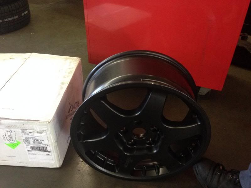

Wheel/tire post 1 of 2...
As all of you know, one of the first updates that folks do if they want to overland their vehicle is to select a more appropriate tire for off-the-pavement use. There are dozens of options available, as well as what seems like hundreds of different opinions. For the LR4 platform, the options are quite limited if you choose to keep your stock 19" or 20" wheels. There are more off-the-pavement options for the 20" wheel size than for those with 19" wheels, but nothing compared to going with an 18" wheel option. Unfortunately, no North American Spec (NAS) LR4s have an 18" wheel option available from the factory and switching to an 18" wheel can be a little challenging due to the size of the calipers (they are huge!) and potential rubbing on wheel wells/AC lines/etc. depending on the size of the tire. Trust me, the LR4 forums are saturated with discussions on tire size and what needs to be done to fit each type/size. A lot of LR4 owners who want to switch to an 18" tire option will purchase one of a variety of available height sensor rod lift kits (these rigs are fitted with an adjustable air suspension, not coils). Basically, these rods work by tricking the height sensor to keep the truck about 2-2.5" higher than standard height. There is a lot of discussion about these lift rods, and several options, but I chose to forego that option because I wanted to stay at standard height and still fit an 18" all-terrain tire with minimal alteration to the stock configuration. If an LR4 owner wants to switch to an 18" wheels, there are a few options below (I welcome additional comments if anyone has another option):
1) Use an 18" wheel (typically from an LR3) and then install spacers to properly clear the brake calipers.
2) Purchase an 18" wheel, I've seen people use FUEL wheels, and then alter them (grinding, drilling, etc.) accordingly to fit their LR4.
3) Purchase a wheel that was intended for use on the LR4/Discovery 4, with the most popular option being from Compomotive (PD1881) out of the UK. These are the wheels that I purchased and I have been extremely happy. They are very pricey, but when it came to this modification, I was not going to skimp.
I think there is also a steel wheel now available from Lucky8 Offroad, but I believe you need to do a little bit of grinding of the caliper to properly fit or use spacers.
Before I post photos of my Compomotive wheels and go into details about tires in another post, I should mention that I kept my 19" stock wheels for a few months and decided to switch to Cooper Zeon LTZs, which is one of the few off-road (somewhat) options if you keep your 19" stock wheels. here are a few photos of the Cooper Zeon LTZs (255/55R19) on the stock black-design package 19" LR4 wheels:

Below are a few photos of the 18" Compomotive PD1881s fitted first with BF Goodrich A/T KOs in 265/65R18. I picked these tires for a few reasons, they were E rated (my rig was going to be heavy), blizzard rated, strong sidewalls, and decent on most terrains I would want to tackle. I chose the 265/65R18 size because it was the largest size I could do without doing a lift or modifications. I had the BFG A/T KOs for about 1.5 years and then ordered the KO2s as soon as they were available, in the same size. I have to say, the KO2s are light years better than the originals and I have been EXTREMELY satisfied in all terrains. Sure, I would love MTs just for the looks, but it is not going to happen on this rig.
Here are the Compomotives with the original BFG A/T KOs, before updating to the next generation KO2s. The guys at the tire shop mounted them white lettering out even after I told them I wanted the black lettering out. They switched it out, but I snapped a few photos with the white lettering out (it's a matter of preference):
Now a photo of the black-lettering out:
Next post.... KO2s!!!

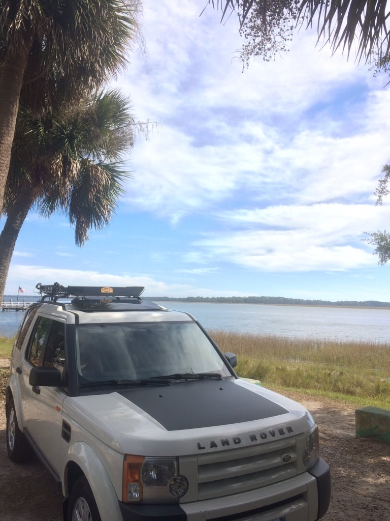

Sweet thread!! I have a O6 LR3 that I recently inherited from my dad who passed 3 mths ago. His goal was to Overland and only had it a year before he got sick again do it my journey to continue it. Dad got the 1/4 rack and ladder and thus far I have gotten Crawolados blackout hood and Proud Rhino lift rods. Trying to save for Ko2. Those suckers are not cheap. lol. And Hella 700ff driving lights

Your rig is looking great!! Love the rock guards and black grill.
Thanks, Rob! Check out my instagram feed, as that has some recent photos of my rig that I have not quite posted here yet with my build story. Nice to meet you!
https://www.instagram.com/finlayforprez/
You will not be disappointed with the KO2s - they are awesome!
