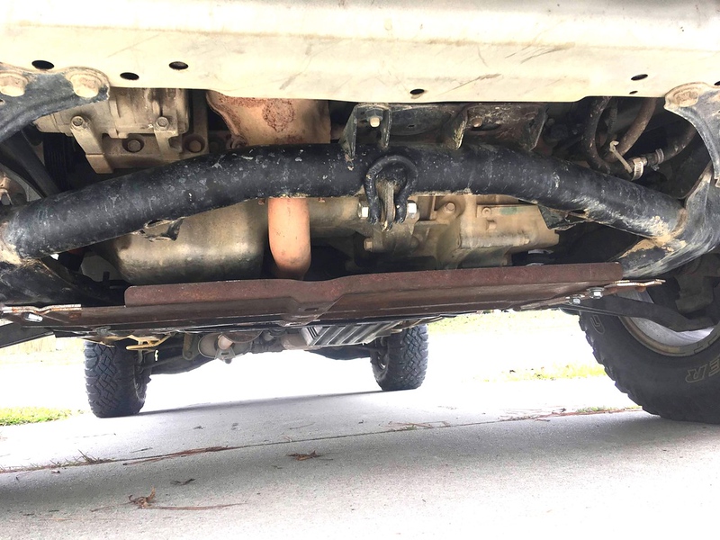

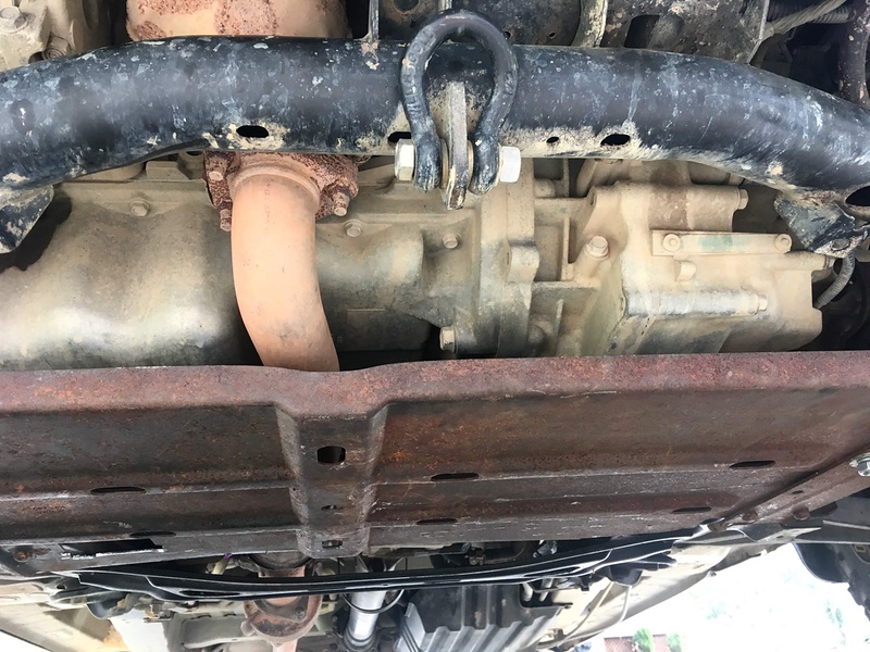

I finally got around to starting my skid plate protect. I started this project with an old fuel tank skid plate that I found at a junk yard for $30. (I think it was an f250 skid plate) As long as you can find a skid plate longer than the subframe bellow the Pilot you basically just cut to fit and bolt it up. On the passenger side I drilled a 1/2 hole through the subframe's 2 existing holes. On the driver side I used a u-bolt through two of the big holes in the subframe. I made sure to cut a rectangle out in the right place so I can change the oil without removing the plate. All of the bolts are secured with split washers to prevent them rattling loose. My next phase will be to create a front portion so the plate slides up and over terrain. It is a little crude, but it is better than nothing.

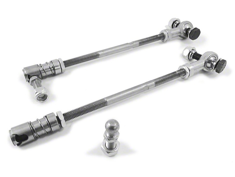

@b0wfin How did you setup your sway bar disconnects? Did you use a kit of some kind?
Right now I have the rear sway bar links removed with the swaybar suspended in the sweet spot where the tire won't rub it a full droop or compression. It took a bit of trial and error to find this location. Body roll isn't too bad as long as my rear airsprings have good pressure. I am looking into options for swaybar disconnects.
I have been looking at these sway bar links as an option for the front. I am not sure if there is enough room in the rear for a similar solution.
https://www.extremeterrain.com/steinjager-rear-sway-bar-disconnect-end-link-kit-for-2-lift-9706-tj-1.html?utm_content=XT Handling - Swaybars and Disconnects|Steinjager&T5_Var4=J125195&intl=0&utm_campaign=XTW+Wrangler+Brands+Medium&dialogtech=ppc&utm_source=google-pla&utm_medium=shopping&T5_Var2=shopping&T5_Var3=orange&gclid=Cj0KCQiAj4biBRC-ARIsAA4WaFjgkE67RhljRA5piyS_g6OjusHSo02fLkJbtU9MwM_8Rgk3kMYqFmEaAgZSEALw_wcB&gclsrc=aw.ds
