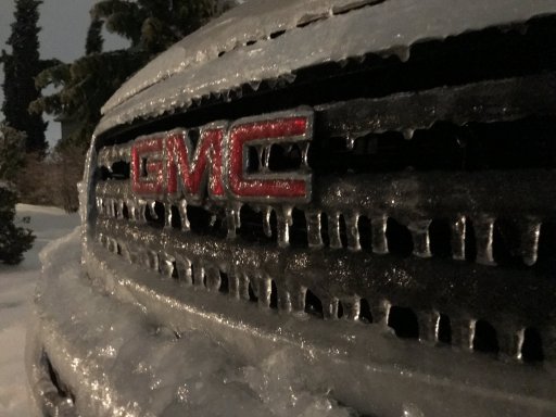

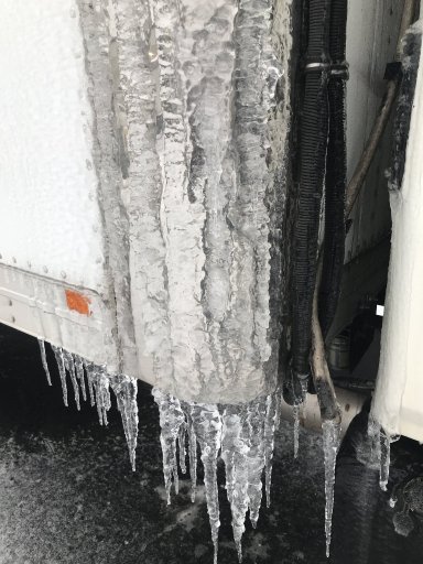

The suspension maxx keys where worth every penny , the ride is so much better and the hight is perfect . I am beyond impressed with the Kenda cleavers in snow and ice . Air down to 20 psi they absolutely helped soak up the horribly rugged roads we’ve had during the storm in Oregon, I honestly know at times I was being a bit of a jack ass with how fast I was driving but not to sound cocky my snow and ice driving skills or what I would say above par so at no point was I being unsafe but I had lots of deliveries to do and going 20 miles an hour was just gonna make things take all day. At times I felt like a Baja truck with how this thing was soaking up the bumps driving by a Tacoma‘s and jeeps that you could see were just bouncing all over the place because for some reason people don’t understand that you need to air down tires when the roads are really rough. I don’t know exactly how many miles I drove but I went through three tanks of gas and I’m so freaking tired and exhausted from working I just want a break at this point LOL. Power was out for three days so it was kind of like we were camping using the camp stove and cooking on the fire pit in the backyard34D151F7-7307-4CF8-84D4-3EF53E3CF65D.jpeg182749CA-E259-4EF4-88EE-B1FD03624C19.jpegFF34AAA6-7967-48D3-806A-C92936BF1051.jpeg86B867A5-ADAD-45D9-989E-BC46AF679166.jpeg25AEB8BE-20FB-42E5-A993-C1E55C31664B.jpeg32ABC6F1-3936-4A50-AF6A-D2174C1FC625.jpegD648356B-E697-48BF-9940-8EA1F98F6E8E.jpeg

Looks beautiful, but so treaxherous! We had a little of that ourselves this week and my Beagle took me out for a Nantucket Sleigh Ride.
We get ice like this now and then, and you can tell as you drive down the interstates because the trees that are in the dividing grounds will all be bent over from the weight of the ice, especially if it got icy, then cold and stayed that way. Those trees will stay bent for years or forever

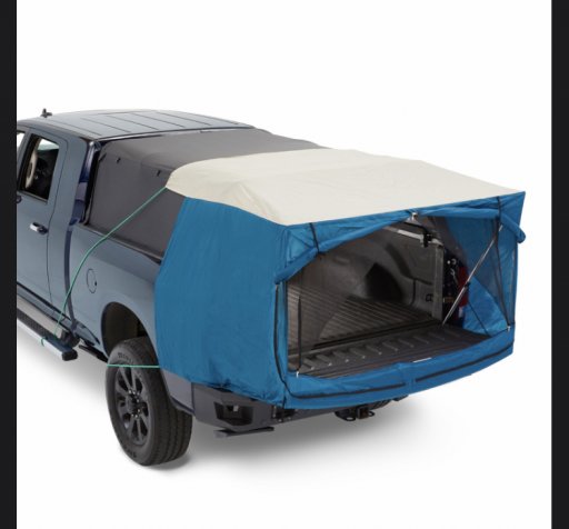

I gotta admit I like the truck better without the canopy , might have to get a soft topper that way I’ll have the best of both worlds plus they make a nifty tent attachment for it 2C3E4E0F-5F57-4AFB-9526-3769FA14DC4A.jpeg74B3C854-5C5A-4E49-9B62-04147EEC235C.jpeg

I DO love the Tahoes, but that's what's great about trucks rather than Tahoes or Suburbans. You have the option of going back to a pickup configuration for when your neighbor asks you to help him move, or you need that load of gravel of patio bricks

Actually that’s the reason I pulled the canopy off I had to go get some bark dust

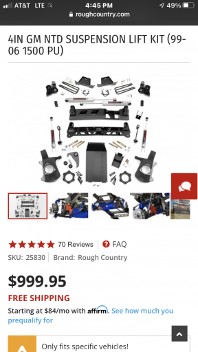

Lift is finally in but I’m doing something I’ve never done before ..... I’m letting someone else put a lift on my rig . This will be the first time aside from a transmission Iet someone else touch a vehicle of mine . I just don’t feel like spending 10-15 hours of my free time wrenching on something . Unfortunately I have to wait a couple weeks to get it in but that gives me time to do some winch shopping

No shame in that. I'm no mechanic. Theres a lot I cant or wont do. And dealing with springs sometimes requires some pretty special equipment and a healthy respect for "boing" factor. I had a shop swap out my coil-overs. I dont have a wall mount spring compressor and didnt want to have a coil embedded into my skull.
Glad your stuff is getting done. Interested in seeing it when its done. This weekend I'm doing brakes, brake fluid and transfer case fluid. I'll stick to that and plugs.
