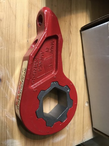

I will never buy a normal set of lift keys ever again , the amount of adjustment built into the suspension maxx keys make it so nice , I went a little to high for my liking but ran out of time tonight so tomorrow I will probably go down a 1/2 inch on the keys but the ride has improved dramatically. I will also get it up on the forklift to see how the suspension travels tomorrow . B74B04FF-AB01-4E34-8D58-9B3E5B05B6E6.jpeg7C699986-25B3-43CC-847A-081E069D53CD.jpeg

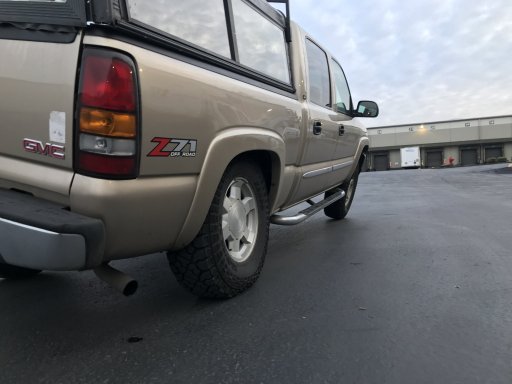

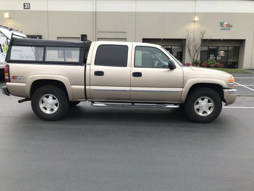

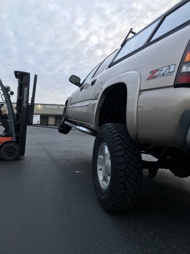

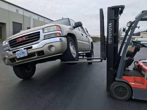

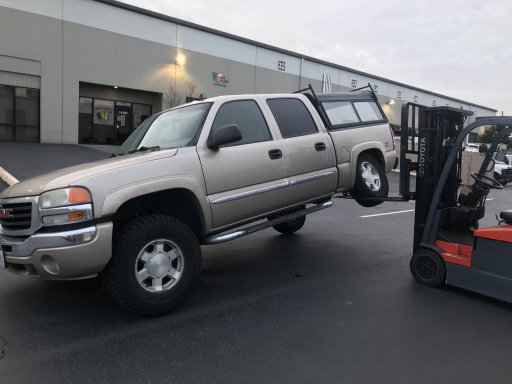

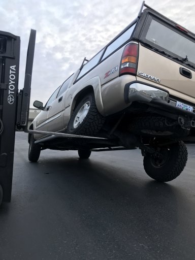

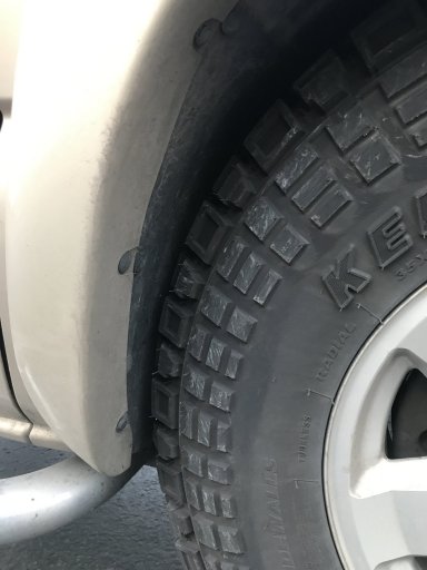

Got some work done today
Dropped the front lift down 3/4”
Got the rear lift blocks in

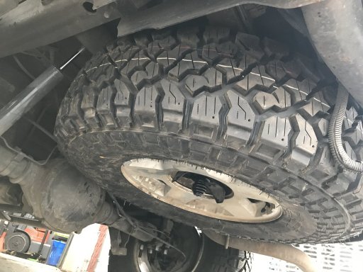

Fixed the spare tire carrier ( problematic in these rigs ) and the 35 fits perfect
Suspension cycles well and nothing rubs at full stuff . 369DA59F-7E20-453A-9D10-CDF0F701FF9A.jpegC6A84B02-9EB6-4BAC-BE75-2C270D7069F4.jpeg0BBBA7C7-5B76-4B1A-BE49-77FC7C1AE6F6.jpeg91FD6169-67A6-439E-8646-8084187099E4.jpegCBED187A-D8B6-4E04-B147-F92366CD8F28.jpegCF0FD0E3-93A7-465C-84FF-48CE24A7D36C.jpeg459F3464-C8E1-490A-A155-65353A07A9E7.jpeg593708E2-4C85-45EF-A02B-4FDE5EC39FBA.jpeg76EC3347-4346-4E56-80CD-DE944276F2E0.jpeg
forklifts are great for suspension work

Nice work. Truck looks good.
Couple questions. I'm curious why bring the front down 3/4 inch if you knew you were raising the rear? Will you be towing or hauling a lot or do you prefer a slight raked look?
Also, when you fixed the spare tire carrier, did that also mean that you did modifications to help the 35 fit, or does the 35 fit with the stock carrier and under-bed dimensions?
I brought the front down to lessen the cv angles .
35 fit fine with no mods , skinny tire for the win again

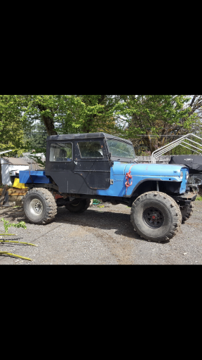

And in the middle of all that there was my long term project of the blue mule
