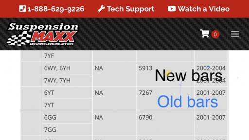

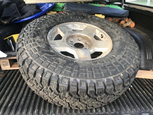

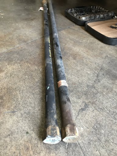

Finally got around to getting to a junkyard to pick up a spare wheel so I could mount my spare and got a set of torsion bars , not the ones I wanted but close enough . Old bars measure out at 2.38” new ones are 1.78”,should make a good improvement in ride quality . Hoping to get them installed tomorrow .

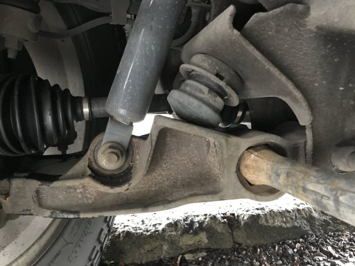

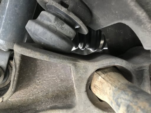

Got the bars installed and well it’s only marginally better and I’m having a strange issue . Even with the lift keys in and them cranked to the max I am still resting on the jounce bushings . I’m at a bit of a loss , I’ve owned my share of torsion bar gm rigs and with the lift keys in I’ve never had a problem getting the front to lift usually it’s the opposite problem and they almost create to much lift to the point I need to run them overly soft to keep the arms right above the jounce bumpers .... I tell ya some days I think I’ve become cursed with vehicles and am almost at the point of just saying hell with it and go buy a new truck so I can focus my time on woodworking.6509E481-15A8-4C2C-BC48-A829F0DBFD2F.jpeg40CC62F4-9D1C-4BA2-B5C1-9F0BFE9DDA1B.jpeg0FAD8253-7135-4216-AEDB-83EECEBA1CF0.jpegF788A1C5-2B17-4234-B79A-2FC29EF232B6.jpegB915D4A6-08FF-4928-8733-AD45EFAF02BA.jpeg

I'm not sure but it looks like that portion bar might be a little thin to fit into that socket in the lower arms, there. I might ne wrong. Second from last picture. Can anyone confirm? I'm no expert
The socket ends are all the same on all the gm bars they only vary in length and width on the center of the bars

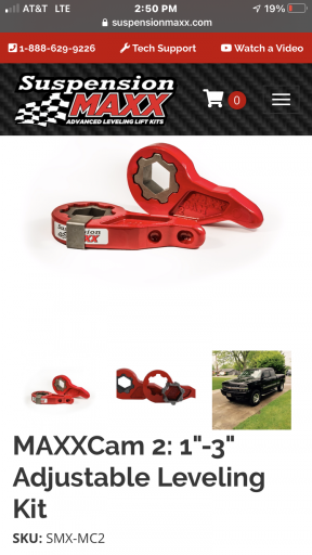

Getting tired of dealing with the torsion bars so going to try these being that they have a lot more adjustment so I can hopefully get the ride hight set to where I want . 38E33ECC-D4E8-4891-93BF-83E0685DA64A.png

If you feel like everything is in spec and that leveling kit don't work you have 3 options from how id see it if it were my truck and i wanted to go bigger on wheels. Option 1 is to do a body lift, option 2 would be a solid axle swap which is what everyone i knows does when they get fed up with it, option 3 is a new truck with new style ifs suspension without torsion bars.
If you realy like how the truck is and rides id go with option 1 its the cheapest and least intrusive. The other 2 options take quite a bit of cash but would fix the problem.

The the suspension max keys don’t work the way I want I may go with the atomic fab coil over kit or just say heck with it and break down and buy a new rig . Loosing patience for automotive work lately .
