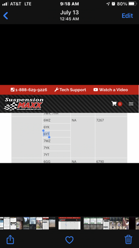

Already did shocks the problem actually is the bars . Going off the rpo codes and tags on the bars they are rated at 7600lbs a piece and normally 1/2 tons are in the 3-4K range depending on what packages where added from the factory . So just to make it ride reasonably comfortable even with the lift keys in it I have the suspension dialed back to stock hight . I just need to spend the time at the junkyard to find the right poundage Torsion bars but just been to lazy .... I mean busy to do it .

I wonder if the rear springs have more leaves than normal and this one was ordered as a "heavy half".
Beautiful and beautiful!
who knows it’s the last year of torsion bar suspension in the 1/2 tons so maybe they ran out of the normal bars and just said “ screw it toss in whatever we have laying around “

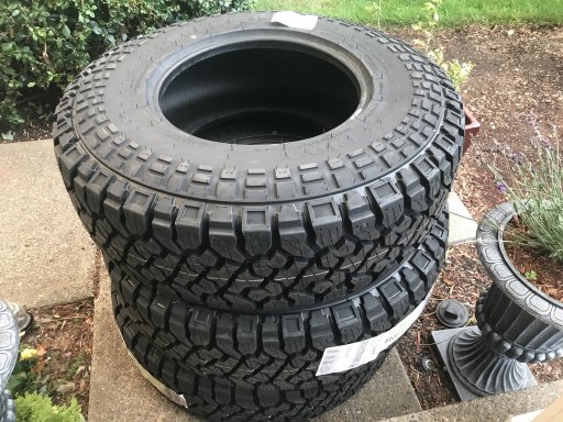

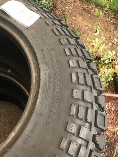

How are those Kenda tires treating you. What's the fuel economy and noise trade-off like? They sure seem aggressive. Just saw some in person the other day
So far really impressed with them , they balanced easy , fairly quiet , seem to work very well in the snow so far . I took a 3mpg hit but will be swapping to 4.10 gears eventually so it should go back up a bit
I was wondering if they balanced well enough. A 3mpg hit? Well, I plan on 33's, not 35's, so maybe I'll only get a 2 mpg hit. I already removed my front air den and leveled the front. I may get a second air dam and cut it in half lengthwise, so there is still a small dam, just not a plow
I was going to go 33s but got the 35s at a killer price
