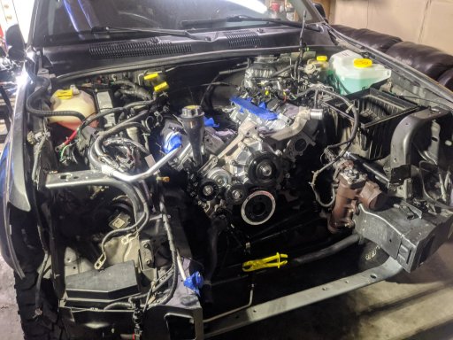

Some good progress tonight. Didn't get started until 4 or 5 and like always with motor swaps it fought us going in. Bellhousing is all secured. Torque converter bolts torqued. Motor mounts done.
Didn't take a pic, but got the new '08 manifold all dressed out including the throttle body adapter etc. too.

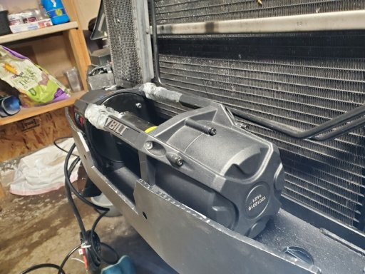

Bracket roughed-in, and winch test-fit:
Where is the handle to lock/unlock the drum you ask? Well we rotated the housing on the winch basically 180 degrees and put it straight out the bottom of the winch bracket, so we didn't have to put a giant hole in the bumper to get to it:
I suppose you could argue that's going to suck if I'm stuffed into a hill-side or sunk in the mud... but it is what it is.

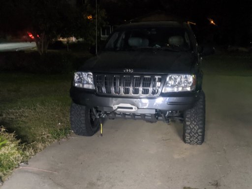

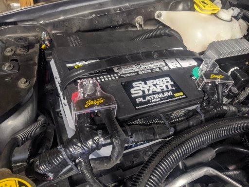

So this weekend we picked up with just putting the front end together and wiring the winch. I pretty much totally failed to take any pics during the process because I just wanted the thing done, but here's what I got.
Here's where we moved the winch control box, with the bumper on it's pretty easy to reach up and plug in if I need to (but the wireless control works great so far):
Here's how the battery terminals ended up, love how the winch leads have their own spot on the terminal to go directly in, no terminals, nothing, just direct in and pinched in (which they claim has better conductivity than any other terminal setup you can do):

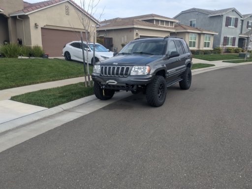

We had to do a bunch of fitting and whatnot, but we got the bumper all on, spooled the winch in, and I drove it home:
Even gave it a bath:

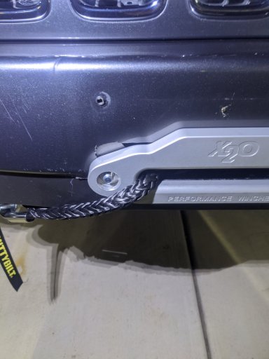

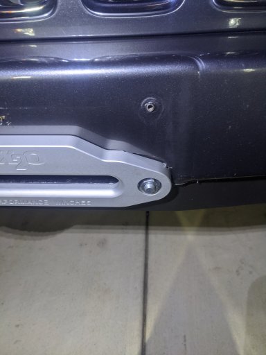

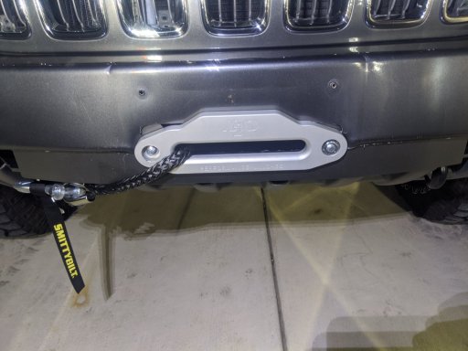

Next up was swapping the fairlead. I had cutout the bumper way back before the first engine catastrophy based on the guide in the HK Offroad winch mount instructions. I will say, the kit fit great and is extremely solid, but the bumper cutting stuff left a lot to be desired. However, back at that point it was when I was stalled waiting for the right pulley for the ATI, so I was just trying to keep things moving ahead. Of course, my cutout for the fairlead missed... bad. If you look at the pics above you'll see it, but here are some cose-ups.
Before:
After (Warn Epic):
And yes, I put the new fairlead on upside down to "hide" the Warn symbol, since I'm not actually running a Warn winch and I'm not a big fan of logos and branding anyway. Also, as you can see this bumper looks good from far, but is far from good. It had a plate mount and bracket on it and the previous owner had obviously rear-ended somebody. In fact, both bumpers have stretch-marks and stress-cracks from hitting things before it was ours... but that's perfect for a wheeler so I don't have to feel bad. :p
And that's where it sits now. I need to go put more miles on it, but I have over 100 miles on it now and it's been flawless.

One other little announance with HK's instructions, is their pics show chopping the first and last of the grey vertical bars in hte lower bumper (along with all of the rest of them). But I don't see any reason why that's needed now that it's on. Here's an example:
I think it'd look cleaner and keep the bumper more rigid with that part left in place. If I find a really clean one in a junkyard this color I may take another shot at cutting up the bumper overall (including how I did the foglight buckets). Or... maybe not cuz I'm probably just going to thrash it on the trail.

No plan survives first contact, right? I tried to get a few pics of the space to work on the front of the engine:
Clearly I wasn't meant to be a professional photographer, but you get the idea. I got a few glamour shots too out running errands and just putting miles/heat cycles on it (literally making it a grocery getter):

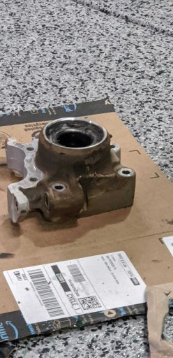

Initially I was just changing the sand wheels/tires off for the dirt wheels/tires (our sand season is ~Oct-March in Glamis). As things go, I figured I might as well grease the wheel bearings while I'm in there. That was all going fine until I got to my last corner and just was not happy with the play in the bearing, and also noticed the grease had blown out way more than any other corner (as witnessed by the very dirty knuckle). So I went ahead and knocked the whole knuckle off. I left it like this last night, and looked into getting a bearing ASAP.
Meanwhile I got an email today that I should expect to stay Work From Home through the end of April. As such, I just ordered all 4 bearings and I'll replace them all (I have to figure if one was on the way out, the rest couldn't be far behind... and the passenger front has a little play starting anyway). Maybe I'll go out later and jack-stand the whole thing and pull the other 3 knuckles.

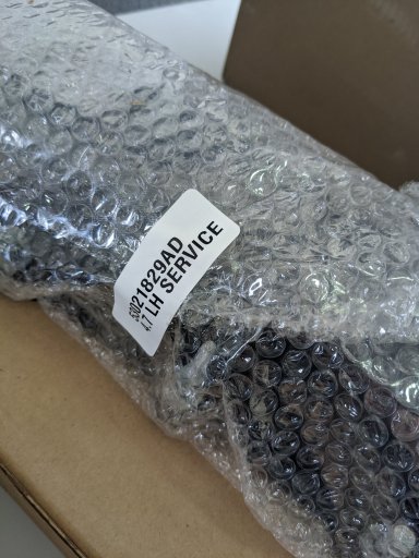

This thing is still in the way of working on the WJ. I decided to just go ahead and do all 4 wheel bearings. The new valve covers did show up though:
