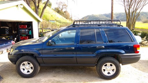

Upcoming trip to Utah dictates overstuffing the Jeep, pulling a trailer, or using a roof rack. I will be hauling just a little too much gear and fuel to put on the roof sheet metal, which is my usual. I'm not a fan of empty roof racks on a daily driver, but I have the roofrack ......... To how I like to do things, i figured a mounting system that I can take on and off at will would be the ticket.
Although this is possible with the Yakima mounts, the rack sits too high for my taste. Also there is no room below the cross bar to do the Toyota mount flip but that gave me an idea. I decided to hang the roof rack off the cross bars anyhow. Used EMT routing clamps and 1/4 inch hardware and mounted directly to the cross bar underside. The cross bars are now part of the rack, I'll grab another set from the junkyard at some point. Simple to install, just snap off the end trim and slide the rack on. Easy enough I can do it alone.
It was a nice day, so spent the time to paint the exposed metal from drilling, trim the bolts, and paint all the new hardware. Also locktighted the nuts. The weak point remains the factory plastic ends. If I see any cracking or have a failure, I have plan B already laid out. But for now, it sits right and will work for the upcoming trip.

I dig the rack mod. Makes me wish I had done that to my Yakima originally. Wonder how much weight the clamps will support versus the other design...
Thanks! A fair bit of thinking did go into this seemingly simplistic approach.
The EMT clamps are pretty stout, my belief is the plastic ends on the cross bars will give out first. That holds true if the cross bars are used with the Yakima mount system attached to the factory cross bars as well.
Also, where I placed the back cross bar is on center (more or less) of where the line of gas cans will sit. This was intentional, and also happened to be a great spot to keep the rack reasonably level.
With the cross bar a little proud above the rack bars, the weight of the cans will mainly be on the cross bar and not on the basket and clamps.
I intend to use the rest of the rack for bulky but relatively light items.
One thing I did not mention yet, once I clean up the rack (it has sat outside in the dirt for a long while), I will run rubber strips down the bottom side of each of the rack's front to back tubes. This way if something collapses, the rack won't be on the roof metal to metal.
Lastly, I do need to disassemble the rack, dry out the insides, and reassemble with RTV on the joints. Or just drill a few drain holes......
Plan B (if needed) is to scrap the factory cross bars and use pipe mounted to the rails with Unistrut clamps, but that will raise the rack a few inches.

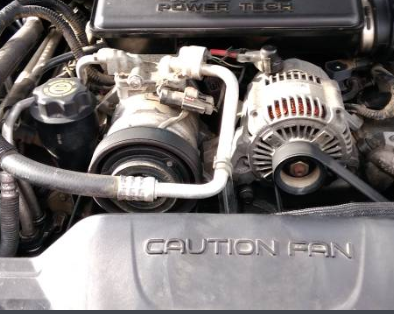

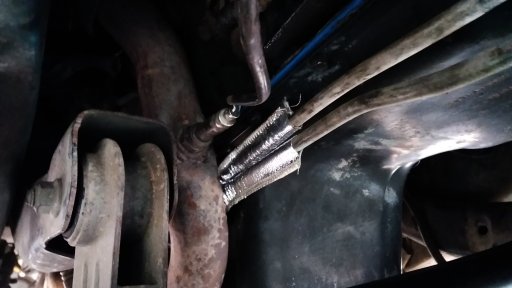

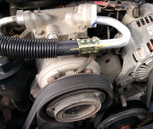

This round of shop work complete. Oil pan gasket, motor mounts, IRO lower rear control arms, and custom AC suction hose all done. Still on the lookout for more leaks, and I see valve cover gaskets likely in my future. Drives considerably better with the new control arms, much less bump steer and far better tracking, feels more like it should. Over 60mph it rolls a lot more free (for lack of better words), the pinion angle correction helped quite a bit (now -1/2 a degree from transfer case, close enough to perfect for now). Time to take it on a 500+ mile road trip and see how it does.
AC Suction hose mod. Needed to make room for a mechanical fan which will come right up almost against the AC clutch. This was accomplished by purchasing the '99 hose, cutting the compressor end off of both, and crimping the new end onto the old hose.

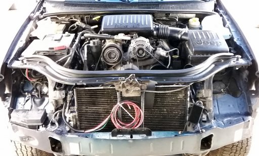

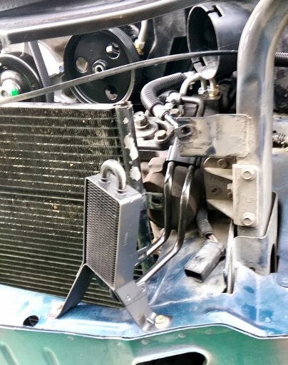

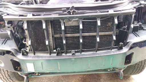

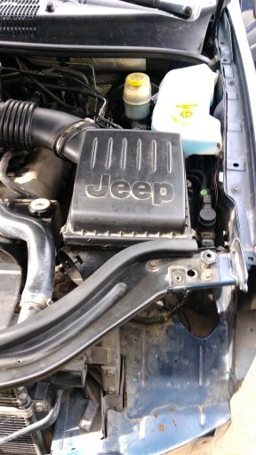

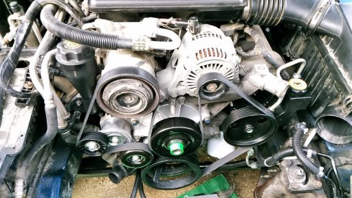

Finally started digging in for the cooling mod.
First the bumper, grill , air filter box, washer fluid reservoir, headlights, and headlight support panel were pulled out. The ZJ reservoir location was worked out and then the front and rear pump locations. Very tight fit but it it can be puzzled in. Next it felt like hours of pulling wiring harness tape off to expose the wiring for the three connections. I did buy the reservoir with 2 ports, so I could either leave out the low level sensor or have a choice to relocate it. Ohming out the sensor, it shows infinity when opened and less than 1 ohm when closed. I figured it was very crowded so I simple left it out and made a jumper for the connector. Not sure if I should put in a 1 ohm resistor?? Anyhow the wiring is straightforward but tactically a mess to deal with. At one point I uncovered a ground junction with 7 grounds tied to it. I cut that all out and ran new ground leads, and upped the wire gauge leading to each of the new ground gangs I made. This was also very intentional, in the future I intend to use the fog light circuit for Rigid LED pods so it was time to shore the grounding system up.
Once the wiring was complete, the reservoir was mounted. A 90 degree for drilling helps a lot here. Next, the evap valve needed to be relocated. It took a little work making and mounting a new bracket, and then extending the electrical connector, but it now sits completely out of the way. Rather than run to the hardware store, I found a very suitable shelf bracket to fab the evap valve bracket from. Throughout this process, all new holes that were drilled were deburred and new bare metal painted with a paint pen. All new hardware used is metric to not confuse me later. All wire slices were crimped, soldered, and sealed with heat shrink. I really do not want to ever have to go back into this particular part of the harness. On completion of this part of the mod, the Jeep was fired up and the windshield washers tested. All works, no alarm codes, and no genie smoke came from the wiring harnesses.
Lastly (for this weekend anyway) it was time to dig into the heart of it. The coolant and power steering fluid was drained, hoses came off, and the hydraulic fan system and radiator came out. I can't say this was straightforward and I would hate to do it on the trail, but with a little patience out it all came. I then broke free the harmonic balancer bolt, and got started on removing the accessories from the front of the engine. Then I was rained out for now, so took the opportunity to wash down the mess I made and clean the bugs out of the AC condenser. I did leave the support bracket and hood latch, as the Jeep sits outside and it is peace of mind to keep it locked up for the workweek. So unless the rain stops, that's it for this weekend!
View attachment 142475 View attachment 142476
View attachment 142477 View attachment 142478
And the rain petered out, so had another hour and a half before dusk to get what I could done. Now its ready for timing cover R&R next weekend.

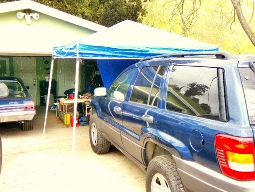

Had just enough daylight this eve to pull the timing cover and inspect the chain system. The gasket was in too good of condition for 135K, I think someone has been there before for whatever that means. But....the right cam chain tensioner isn't locking, and the left tensioner is frozen collapsed and the chain loose. Main chain tensioner looks AOK. Can't believe I didn't hear a chain slap around. Very glad I took a look. All else looks fine, the guide plastic is all there and everything else looks serviceable so maybe I got lucky and found it in time. A right and left tensioner now on order.

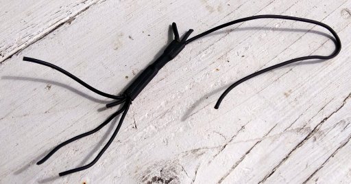

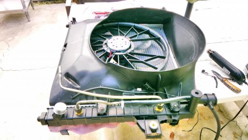

Decided to pull out the cooling parts and start test fitting them together. Assembled the 99 radiator, transmission cooler lines, electric fan, fan shroud, and fan controller temperature probe. I can see why WJs occasionally break radiators, the weight becomes significant. (Now for someone who just wants to run the mechanical fan, removing the electric or hydraulic fans saves considerable weight.) One note to pass along is the fan shroud fits the 99 radiator perfectly, if you use a later model radiator it will be 1 inch shorter and there will be a large gap between the top of the radiator and shround. This could be filled with foam. Second, the 99 shroud mounting tabs only line up with the later model radiators top mounts, and not the bottom 2 mounts. Using the matching 99 radiator is the way to go.
Three things to consider when installing a temperature probe of this kind. First, the internet of things likes to say this style of probe does not work well with aluminum radiators, or works fine, or works ok. Who knows, I will find out. Provided was just a bare probe, so I made rubber tabs to sandwich it on either side of the radiator (a 17 caliber empty shell case works great as a hole punch on the rubber). the idea is to both keep the probe from moving and provide a pocket of insulation for full heat sinking. I also installed shrink tubing to shore up the delicate wiring and wiring to probe connection. Second, the depth of the probe is very important, as the AC condensor is very close the to the radiator when everything is mounted up. since the end it tapered, and I only had about 1/4 inch exposed, the tapered tip of the probe is insulated with marine grade shrink tubing (with adhesive). Not sure if this will work as I do not know the melting piont of the adhesive.
View attachment 143680 View attachment 143681 View attachment 143682
Lastly, it doesn't matter if it is a probe or a temperature sensor, there are two theories of where to mount it. Most kits call for mounting at the heat source, either near the water outlet of the engine or in the radiator right by the hot water inlet. When mounted in this location it is all about reading and reacting to what the engine temp is doing. Some kits (usually the high end PWM stuff) call to mount the sensor or probe on the cool side of the radiator or on the engine water inlet hose. When mounted in this location it is about reading and reacting to how well the radiator is cooling the water. Do your own research and decide on which theory or logic appeals to you I prefer the feedback loop of the cool side mount and thus mounted the probe in the lower left corner of the radiator.
After test fitting the assembly, it appeared there is enough room to install the overdue mechanical fan from the underside of the vehicle with the radiator and shroud mounted. So I decided to start putting things together. Once the radiator assembly was in and the ac condenser mounted, the hydraulic cooler was mounted. The bolts on either end center line mounted fine, but the 99 radiator mount for the top bolt is about 3 inches different than the later model radiator. Since the mounts are on the same plane, I'll just make a bracket to tie the mounts together (on another day!)
View attachment 143683 View attachment 143684

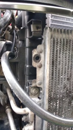

I began figuring out the plumbing to the transmission cooler lines. Since the Russel 180 degree fittings are still on order, I attempted to hook the lines up using cut off fittings from the old hydraulic cooler lines. With everything disconnected, I was distracted by a shiny object and took time to run heat shielding over the lines where they pass very close to the passenger exhaust pipe. I think I will try and source the Russel connectors for faster delivery and hold off. I do not like how much cooler hose I will need to make the temporary setup work. Test fitting the headlight support revealed I will need to do a tad of trimming where it meets the '99 power steering cooler. And somewhere in the mix, I think I punctured the ac condenser. Oh well, its pretty ratty, beat up, and warped anyway.
View attachment 143685 View attachment 143686
