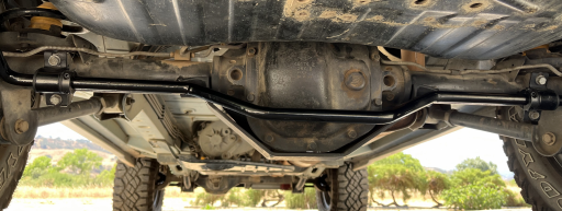

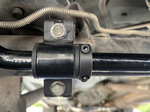

Addco 7/8 sway bar installed. First on-road driving impression- I LIKE IT. Very neutral and predictable. A lot of the wind drift is now gone. Now it drives with the complete personality of the underinflated LT tires.
After aggressive test drive, evidence the bar was walking right and left, and settled way right after drive. Added a couple of shaft collars from the local hardware store. Should stay centered now.

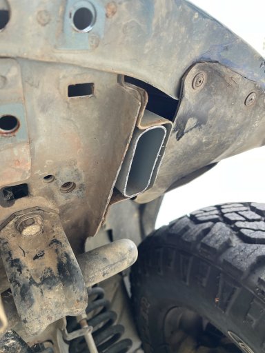

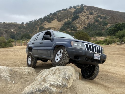

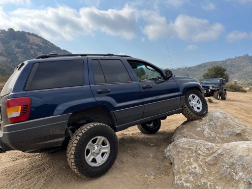

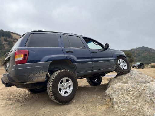

After all the mods (springs, bumpstops, rear sway bar, larger "32" inch tires, IRO 2.5" cat back system, etc) headed to Hollister Hills on Friday morning to check flex and clearances. Ran with tires at 16 psi, front disconnected, 7/8 rear sway bar, at daily driver weight/load. Crossed it up both right and left sides. It was a good day. All works with no issues, and I did find where I could get more droop on both the front and back.
- Everything just clears in suspension and wheel wells (front stuffed to crushed bumptstop, rear just touching bumpstop).
- Might be able to get a hair more stuff on front tires if I moved axle back about a half inch and took a bit out of the front bumpstop extension. Not really worth it.

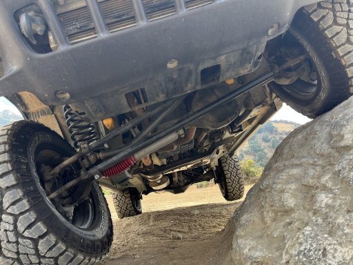

- Happy with front flex overall, but droop is limited by shocks that are a little short. Changes coming there.
- Happy with rear flex. Overall satisfied with 7/8 sway bar compromise. Great trail manners and decent on highway. At daily driver weight it definitely did not flex like the factory tiny bar. But it did OK and will respond with more flex when at full load out weight. I did discover on full droop the end of the bar was almost vertical. This tells me it might be limiting droop. It needs longer rear sway bar links to position the way bar better when rear suspension is crossed up. And I should get a hair more droop then as well. With the magic of Amazon, links are on order.
- Have a little less flex than the previous blown out stock arm/bushing budget boost on a factory rear sway bar (subjectively, I never measured it crossed up with the old setup). But it feels a whole lot better and under control).
- I do not have the rear vari-lock fluid and modifier formula right yet. Had some trouble getting it engaged. But as you can see from the pics I did get air under the back tires when crossed up.
- Love the Iron Rock Offroad "hybrid" muffler sound. Perfect for an older guy like me. A little extra at idle and down low, but no added noise at cruising speed.
- The extra 1.5 inches of ground clearance (over the budget boost) went a long way in floating over obstacles I used to scrape and sweat over.

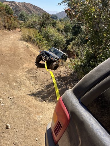

- Gave a TJ a yank that was in a precarious spot. Backward any further and front tire would drop down far, risking roll over. Too steep and it didn't want to go forward without crabbing the wrong direction. Sometimes we all need a little tug in the right direction! Steeper than the pic makes it look. We both slipped and fell on our arse a few times getting the strap connected.

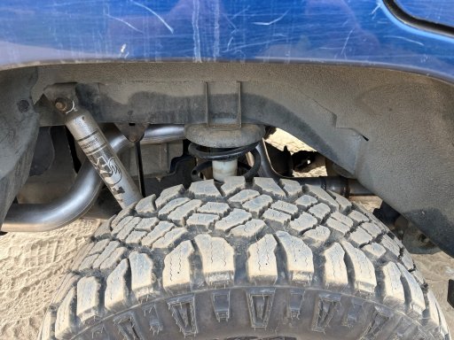

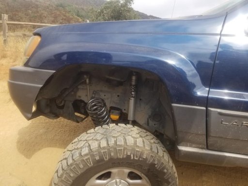

Testing and tuning, take 2:

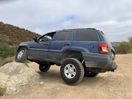

Fox 2.0 Adventure series IFP shocks for 4 inch lift added, with bar pin eliminators on the front shocks. Edelman new steering box installed. Cat pipe flipped, final exhaust alignments and muffler welded up.
1 trip to San Luis Obispo and a loop around the backside of Lopez lake for a test ride a couple of weekends ago. Last Friday another trip to Hollister Hills for flex and clearance testing. And add a Gloria Grade washboard round trip to a shooting match last Saturday.
On Highway impressions- New steering box helped to reduce wandering and feel that it wants to death wobble on rough road. Better feel in the right direction, but only a little better. Change of shocks is exactly as predicted, moving from progressive to linear dampening. Trail and road "chop " is less harsh, but have a bit of rebound hop in the rear when unloaded. I was appalled at first on the Fox shocks, they were ridiculously stiff when first installed but settled down quickly. Otherwise on -road the shock behavior is completely muted by the switch to LT Duratracks. Still hunting for the right tire pressure, and the WJ handling is as expected with heavy, oversized, underinflated tires.
Off Road experience: The easy maintained road behind Lopez lake and Gloria grade, (despite the washboard) were a nicer ride with the Fox shocks. The Duratracks suck on the most common non paved terrain around here- dust, marbles, and sand over hard pan. Flexing at Hollister Hills showed an improvement, on the same rock pile as I tested last time I was no longer getting air under the extended tires. The longer shocks are definitely giving me more droop. But did see that I am marginal on bottoming out the shocks in the rear before the bumpstops. On the front, definitely bottoming out the shocks before the bumpstops. All mechanicals clear flex, including exhaust. Did a few trails while there, and dropped a front spring twice doing the little tunnel on the adventure course. That's new to me!
What need to be done- For the front, need to remove the bar pin eliminators and see if that is just enough to keep the shock from bottoming out first on compression. also it may reduce droop just enough to keep the front spring on. Hoping I don't need to go to a spring retention system and add bumpstop extension length. Also will drop my front pinion a little and sacrifice u joint angle for a little more caster with the hope of improving on-highway manners. Lastly, on next flex retest will unhook my rear sway bar and get a better idea if I need to extend the rear bumpstops. (and last ditch if I need it sorted in a hurry I will just put the shorter Bilsteins back on and call it a day).

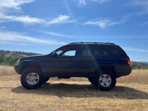

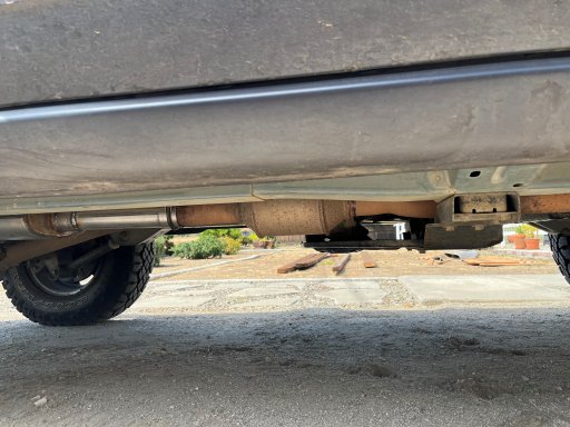

Exhaust note: Love the mellow sound of the IRO 2.5 inch hybrid muffler. Just enough extra to notice sometimes and otherwise mellow and free flowing. The lower cat pipe has a dog leg lowering the cat, a free cat tuck is there if you can get the pipes loose! Roll the pipe half a turn and point the dog leg up. The exhaust system sits considerably higher now than the old stock cat back system did.

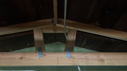

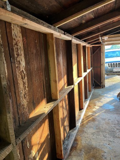

Hopefully I will get the garage retrofit done soon enough to get back to the Jeep. Rafters rebuilt and 1 wall strengthened up, 1 wall to go. Walls no longer bow out and roofline no longer droops down. When done this 100+ year old former tractor shed should still be standing at least until I am not.

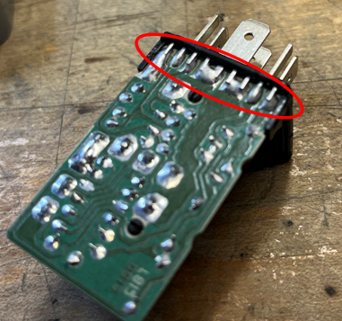

Had to do a little adulting and let the suspension alone for the moment. The WJ's left blinker didn't work intermittently and eventually almost never. Gotta love the Tube of U (I like the content, not the company so I don't like to call them out proper, please ignore my ism), there was more than one video showing the blinker relay usually is the culprit- cold solder joints that crack with age. By naked eye all looked very good- but sure as shootin', under 7x microscope, 5 of 9 contact spade solder joints had cracks in them. Reflowed the solder with a little flux and inspected, slapped relay cover back on, installed and tested good. Right/left blinkers work on command now! No money spent and less than an hour start to finish.

For anyone still following here is a suspension update:

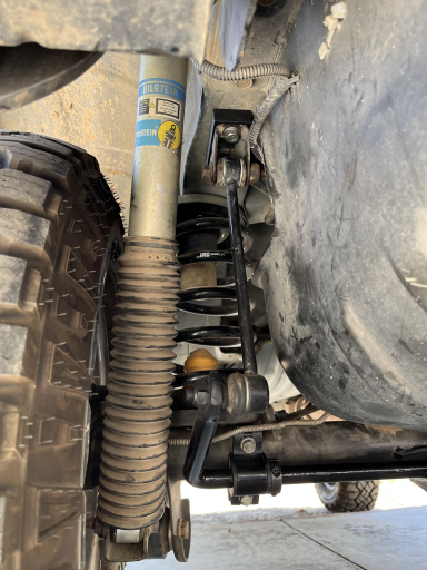

Fox shocks for 4" lift too long, even without bar pin eliminators on front I was dropping front springs. Also bottoming out on front and rear shocks so needed to extend my bump stops. Decided to put the Bilstein shocks back on sized for the previous budget boost. Lost droop as expected, but added a little length to the front shock to make up what I could. No longer dropping front springs and did lose suspension droop, so a trade off for reliability. I may look at extending or somehow moving the mount on the rear shock to give back some droop, if a common sense solution comes to me. Not too worried as I wheel with the rear sway bar on anyhow. As for the front- I will revisit the fox shocks and spring retention if I decide to go long arm in the future. And somewhere in there I did install longer rear sway bar links to set it at a better angle and safe from going full vertical on full droop.
Mid next month I will hammer it on Bald Mountain and see how it does. In the meantime, STILL waiting for my H&K Gate Keeper radiator guard- ordered mid-June! And with 1.3 degrees caster, intend to shorten upper front arms to add another degree and flirt with front u-joint angle. Give and take, there has to be a sweet spot somewhere!

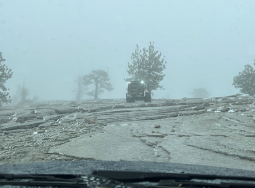

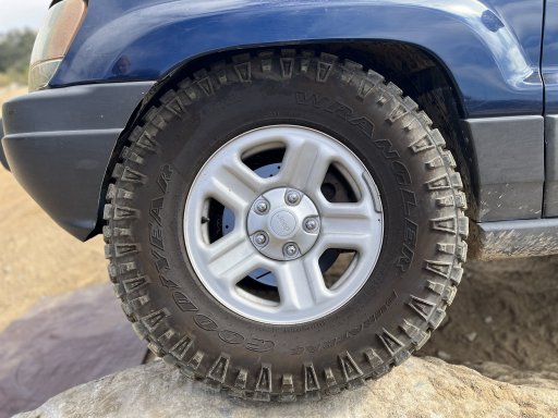

Day trip to Bald Mountain in this weekend's first decent storm of the year. Rain, slush, snow. Last time on this trail was 2019 with budget boost, 30.5 all terrains, and stock suspension. This trip is after all the mods per my previous posts (fully adj suspension arms, 3" IRO springs, "32's", 7/8 rear sway bar, trimming and bumpstop tuning, etc.). It was a nice shake out both on and off highway.
Highway: Figured out a tire pressure that seemed to work well for the Duratrack LTs. 25 front/28 back. No feeling of wanting to death wobble, very sure footed and no bouncing around on potholes, tolerable lean on cornering. Much improved highway manners, including a sudden evasive lane change on hwy 99 with full control. I still plan to add a little more caster angle but it feels a heck of a lot better on road.
Trail- Duratracks at 15 PSI. Stuck like glue. I do not like them in summer marbles over hardpan around here, but they gripped incredible in the Sierra terrain. Per reports of the caravan, it is getting great flex and tire stuff, with no sounds of suspension metal to metal, not a single tire rub heard even with it disconnected. Running the Bilstein's sized for the budget boost with bar pin eliminator to help a little with droop (took longer Fox shocks off for now). No springs popping out and never felt like I needed more droop. WJ did incredible, at one point serving as a winch point for a gen 3 4 Runner that had to figure out traction control woes on the gatekeeper climb.
Summary- It was more fun with less tip toeing around than the 2019 trip. Same reaction as then from the IFS guys about the WJ soccer mom's Jeep flex and performance. I'm a very happy camper at the moment with the performance and capability. Unrelated to this trip, only repair is a leaky diff seal that needed to be done before the trip anyhow.
No action shots, due to weather I could not get any volunteers to hang outside on the fun sections.

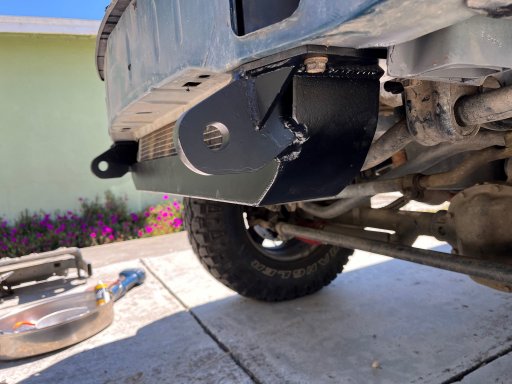

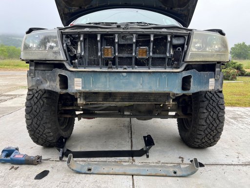

Sometime last winter (or last spring??) finally upped the armor a bit, and protected the WJ radiator overbite with an HK Offroad GateKeeper radiator guard.
Remove front bumper skin, remove recovery hooks, cut off old support, cut off lower radiator mounts to about 1/4 inch.
Reinstall rubber radiator mounts, bolt up Gatekeeper armor, cut a little more off the bumper skin, install bumper skin, and done!
Pretty straight forward once I got over taking a sawazall to my WJ again. Of course the usual- clean up bolts and threads being re-used, clean up and paint fresh cuts, etc.

My license plate is all over this thread, so screw it, here are the pictures:
