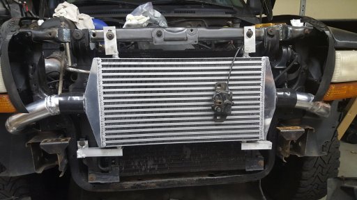

Well after close to 2 years of only 2wd I finally saved up and loaded the front D44. RCVs, OX locker, premium hubs, matching 4.56s. Gear pattern hit on the second stab. I havent hooked up the cable yet on the OX but it works with the drive away bolt. I had to use a tom woods offset ujoint on the tcase side cause at full droop its almost 34 degrees total. At ride height its only 5 degrees.
20230923_091439.jpg20230923_130432.jpg20230930_163000.jpg20231009_161447.jpg20231017_120139.jpg20231017_164803.jpg20231017_165939.jpg
