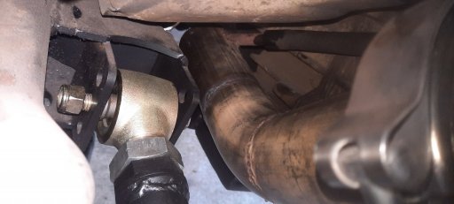

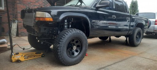

Well I drove it down the road today for the first time since last year. I think it might sit higher than I was thinking but first its time to do the rear. Ill start on that tomorrow.
Cut the bumper to clear the tires.

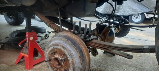

An 05 dakota rear going in. (5x5 matches the front dana44) Emer brake cable is gonna be fun its a little different. Will also need to swap my gears over. Will need a block to level it most likely. This rear is temporary till I build a for 9in for it.
Reactions: GLOCKer

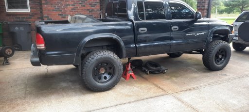

So the 2005 rear is in and here is what stock hight looks like.
But after a shackle flip and and other tricks ,if needed, I will be able to raise the rear 6 inches. The front will come down a half inch I am shooting for. Its gonna sit higher than I wanted but Its not terrible. Definitely will need to get those slider/steps installed sooner.
