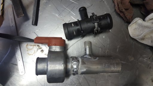

So found a few spare moments to throw the front diff back in and noticed a little bit of coolant weeping from an outlet connection next to the kats heater I just put in a few weeks ago. So that sucked up most of my time but now its solid and eliminated a short hose some plastic and a couple hose clamps. 20181201_142841.jpg

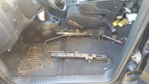

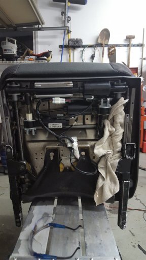

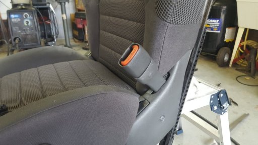

Its time for the best mod on the planet for any 2nd gen dakota. After 285K miles the drivers seat , that was uncomfortable junk even when new I suspect, was completely shot. It was bad. A 20 min drive would leave you in pain. So I found a fresh victim in the junk yard. A 2011 pathfinder with 6way power and only 80k on the clock. Took me a solid day to fab it up being about 3 inches wider but man its like a new truck!
1572309738591.jpeg20191024_193141.jpg20191025_103342.jpg20191025_103541.jpg20191026_162033.jpg20191024_180357.jpg

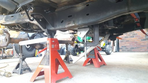

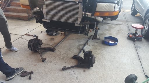

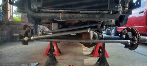

So after using all my free time on other stuff it was time to replace ball joints again. This time im using a plasma torch. Im sure these ball joints will last much longer and I hope to have it linked in a few weeks. First hurtle is trans crossmember. Looking like a 3 link is doable but I dont want it to sit too high. We shall see.
Links are figured out now. I have should have atleast 4 inches of up travel.20201205_165112.jpg
This mock up 33.9 inch tire has some room to spare so a tall 34 or 35 should be doable.
