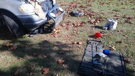

This past weekend I went camping at Curtis Creak in the Pisgah National Forest in NC. It was my first time there and I learned a few things:
-I should upgrade my shocks and rear springs next year.
-My catalytic converter is making the weird noise I've sometimes been hearing when I hit a bump. It got really bad when I went up a mountain road to the Blue Ridge Parkway, but after I got back on road it quieted back down.

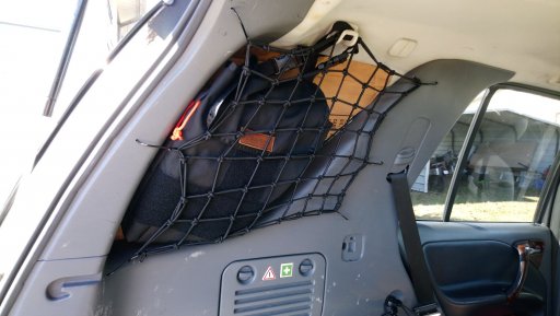

-I need to simplify my gear. Specifically downsize what I can, and get more storage bins for everything. I had less things floating around this time than the last time I went camping (thanks cargo net!), but it can be better.
I had a great time! and it has me thinking more about what I need to do to the Merc now that I've actually been on a camping trip with it. One of my friends who went tried out his 'beta test' of his tent for the back of his truck, and it turned out really well.

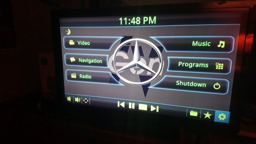

I recently got a Raspberry Pi and plan on installing it in the vehicle. I still need to buy a touch screen and other attachments, but my goal for it is to have; music player, navigation/GPS, a backup camera (although I might just have a switch on the monitor so the camera displays when the car is put in reverse), filled with fun InGen/JP stuff (documents, photos, dinosaur list, ect...), and able to access ML computer and let me read codes and have a digital readout of the systems. I don't know what all I'll be able to read, but if it can tell me what codes are being thrown then that'll be okay.
