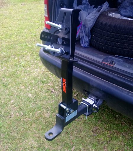

-The two pieces for the spare tire carrier arrived

I'm super excited about the tire carrier! I need to make some modifications to the carrier I bought (Curt carrier needs to be cut and then a new hole drilled so it'll work with the Masterbuilt folding receiver bar), but the plan is for it to be able to fold down so I can open the rear hatch. Either this month or next month, I'll be getting a full size spare and putting it into my tire rotation.

Later this month I'm planning on getting the front bumper repainted, and the tire carrier put together. As soon as I find a touch screen I like, I'll get back to work on getting the Raspberry Pi set up.

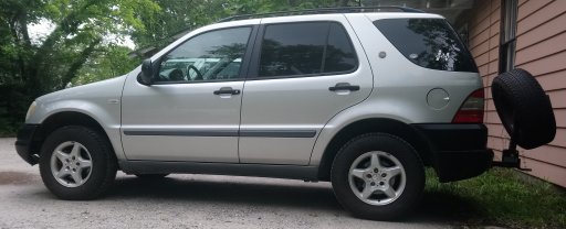

I got a full size spare tire in last week, and this past weekend I painted the front bumper. Hopefully later this month I'll be able to get the torsion lift done. While looking for a wiring harness for the trailer lights, I found the OEM hitch kit that included the wire harness. After some internal debate, I bought the kit and will be installing that this weekend.
Yeah, I realize I already bought an aftermarket one, but after seeing how much beefier the Mercedes frame reinforcements are, I figured it would be worth it to get those considering the weight I'll be putting on the rear (bumper armor, spare tire carrier, and eventually towing). When I install them I'll take some pictures comparing them to the ones I bought earlier.

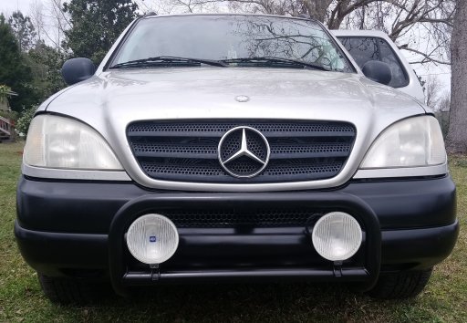

This month I attended a minor meetup at Brown Mountain in the Pisgah National Forest (NC). I was with several Tacoma's, a Tundra, and an Izuzu Trooper. It was the first time I had ever been on an OHV trail, and is probably the first time my ML320 was off road.
Aside from hitting a root with my bumper (minor damage), the only damage I have are scrapes along some parts of the underside (and I bent my bull bar along with cracking the fog lights). I really need to fix my clearance...

I realized I never posted pictures here of my completed spare tire assembly, so pictures are below. I also installed new headlights!

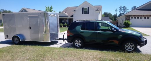

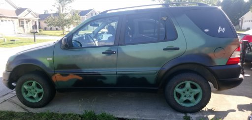

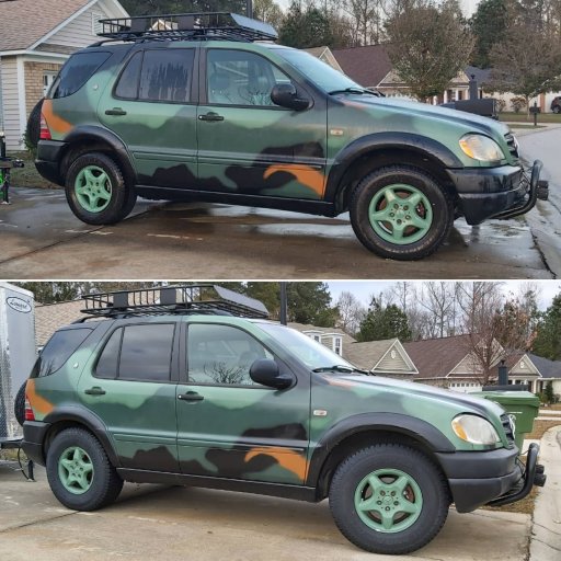

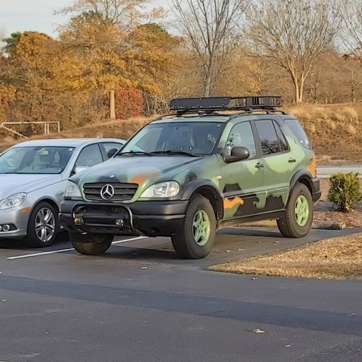

Well, last month I was laid off from the park, and used my unemployment monies to get the ML painted and to buy a cargo trailer! I was kicked out of the ranger house, and it took me far too many trips to get my stuff moved out in the ML, but with the trailer I can fit all of my things in it and move in one go.
I still need to paint the rims (they'll be painted the lighter green color), and will hopefully do that this week now that I have a few days off work. I was hired back at my job the week I finished painting the body, so I didn't have time to do them when I was laid off. Later this year I'm hoping to get the rear lift done, but that entirely depends on if I'm able to get a higher paying ranger job or not, since it'll cost me 2 months worth of my current wages...
The paint isn't 100% movie accurate, but its accurate enough for my taste. Plus, with the overlanding changes I'll be making (different roof build, spare tire carrier, no holes in the bumper armor, ect...), it wasn't going to be a perfect replica anyway.
I'm planning on building the trailer out to be a base-camp camper, and to live out of if needed depending on what future ranger jobs I get. Its a 6x12 with a ramp, and currently weighs 1200lbs. I specifically wanted one with the RV latch side door, and this one happened to also come with rear stabilizer feet and interior light fixtures. Originally I was going to get a used one, but so many in my area were in various states of decay, and the decent ones were almost as expensive as a brand new trailer. So after talking with one of my friends about it, we decided it'd be best to get a new trailer and have a clean slate to work off of. I'm debating about making the exterior theme of it to match the trailer from The Lost World, but we'll see about that!

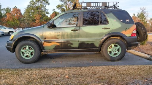

I haven't really done anything else to the ML in the last couple months, save for putting the spare tire and the roof rack back on. I joined a ML group on Facebook where a few members have theirs built for off roading, and I've learned a few things for how to move forward with getting it lifted. As usual, just waiting for funds to build up...

So a couple weeks ago I found a nail in the sidewall of one of my tires...which couldn't be patched (I'm not trusting a sidewall patch unless its the only option to get to a tire shop) and so thanks to the all wheel drive nature of the ML, I had to get all new tires.
Decided to go from 255/65r16 to 265/75r16 tires for some lift. I was originally going to get the rear suspension lifted and then get 285/75r16's on it, but without the rear lifted those size tires would rub. So, happy in-between.
