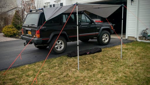

My DIY awning. Wanted something that could support multiple configurations (3 different sizes), be self supporting (no poles) if the winds were calm, but also support windy conditions if need be , could swap sides as needed, be packed externally during travel and not get in the way of rack space for boats, and be removed entirely when not needed. Budget ended up being about $150 ($190 if you buy all 3 separate tarps). I splurged a bit on the tent/tarp poles. Everything packs down to about 53" long.
Parts list and sources listed below the photos. I didn't include specific instructions because the final fitting will probably be unique to each vehicle and rack setup. There are VERY few complexities, so the pictures should provide the basic idea pretty well.

The idea is to have all of the tarps in the same bag. So additional benefit is that you have spare tarps for other purposes should you need them. All are actually designed as hammock, footprint, and general use tarps. But not to be confused with the heavy duty plastic tarps you buy at hardware stores.

This was about the only item not purchased on Amazon. It is hard to beat the price for these either. They are 3-section all aluminum painter's poles. They are about 54" collapsed. They are advertised as 5-12 foot poles. They have zero wobble, but of course the more they are extended the less overlap each pole has internally. That is why for the bigger configurations, I purchased the additional tarp/tent poles. Plus between these poles and the tarp/tent poles, the configurations become almost limitless, and you can help a friend should they need a pole for something.
