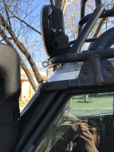

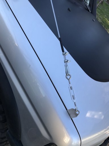

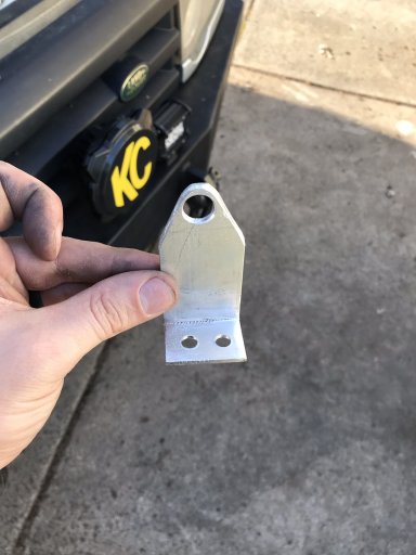

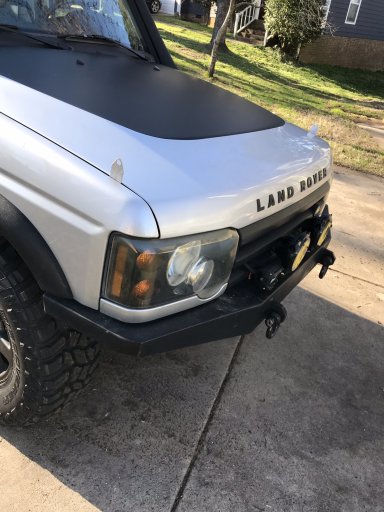

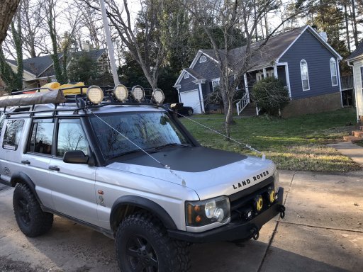

Had some free time yesterday, so I made some tree limb risers. Took a piece a aluminum and bent it 90° in a vice then cut it to size so it fits in the fender hood channel. Then I drilled some holes in it for mounting and one for the limb riser. Was pretty easy to get them mounted just had to pull the fender liner out and head light. Once I got those mounted I drilled holes in the rack and put in some eyelets. I attached the turn buckles to the loops for the 3/16” coated cable. Took the cable and ran it up to the carabiner that is attached to the eyelet. Secured the cable and boom got me some risers for like $30 and about 2hrs of time. Made sure it can be quickly removed since this is a Land Rover after all and we know I’m gonna need to get under the hood more often than other vehicle owners!
