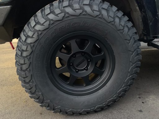

I’m really excited because the new wheels just arrived yesterday, getting wrapped in brand new BFG KM3’s and being mounted on the truck tomorrow afternoon. Just in time for our 2 week trip into the Southern Arizona desert. I’ll post pics as soon as they’re rollin’!

One last comment for the day.... I keep forgetting to give honorable mention to the new wheels too. Method Racing’s new trail model with inner design to act as a quasi bead lock without the need for a conventional bead lock set up. I ordered them from 4Wheel Parts and it took a while because this was only their second order for them. They haven’t picked up steam yet, so we’ll have to see how their claims hold up. Apparently I can air down to 10 PSI and there should be much less likelihood of the tire coming off the rim. Not that I want to test it, but we’ll be in lots of sand, gravel, and wash board roads....so I’m looking forward to seeing how they work at low pressures.

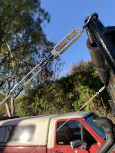

The limb risers worked like a charm on a recent trip across the Southern Arizona desert. Especially in the washes where brush, mesquite, and other flora was growing across at windshield height. They picked the limbs up and tossed them over the top. Added a bunch of new desert pin striping to her. Doesn’t look so unused any more!

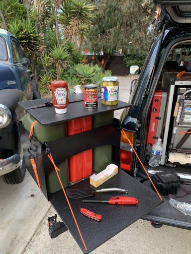

We needed a small work surface to get things off the tailgate in order to allow the lower drawer and fridge drawer to slide out over the tailgate. We were constantly having to shift things back and forth and wanted a simple solution close by and easy to set up. Hard plastic material cut to size, fits perfectly slid into the back of the jerry can holder. Works like a charm. IMG_0325.JPG

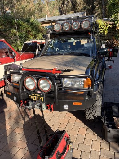

Getting ready to start a complete revamp of my lighting system. Switching from HID’s to LED’s. Have a friend who recommended a very good American brand, Baja Designs. I like the old school look of large rounds vs a light bar. 9” rounds like the ones I have on there now....just LED this time. I’ll be running one LP9 spot and one LP9 flood (both ambers) up on the front bumper. With white small floods in the bumper. We’ll add ditch lights tucked up under the side front fender bars. On the upper rack, 4 of the 9” LP9’s in white, 2 floods, 2 spots. On the sides...S2 site lighting, one red, one white, on either side of the roof rack. On the back, their new tail light bar with running lights, bright brake lights, Amber bright running lights, and a center white light for general site lighting or back up lighting. Rock lights on all four corners....White up front, red in the rear on separate switches. Red and white lighting on the tailgate with manual switches and same under the hood. I hear the red lights are awesome for bug reduction at night. After I spec’d it all out with wiring harnesses.....$7k! Now I know it’s a lot of lighting, but I about fell off my chair! I may have to rethink my lighting plan!

Christmas in April!! 3 weeks until install will be complete. I think I underestimated the magnitude of this project. Lots and lots of wire! I’ll post pics when the fun begins. I think I got pretty much got everything Baja Designs makes! Can’t wait to see these light the way!!! I’ll hope to have it all done before Overland Expo West next month in Flagstaff, AZ. Just signed up for all my classes. Should be a good time.IMG_0652.JPG
