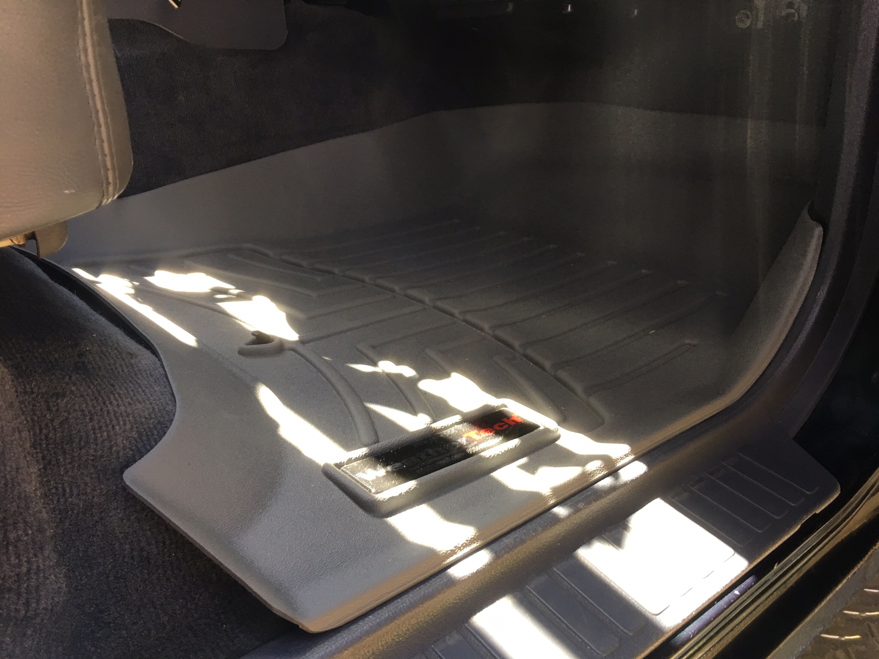

The name comes from the sour milk spilled on the floor mats from the previous owner masked by the pine scented car wash rear view mirror hung air freshener. Smelled like an old poopie diaper under a pine tree! Replaced the mats with new Weather Tech laser fit floor mats....presto-change-o, smell go bye-bye.

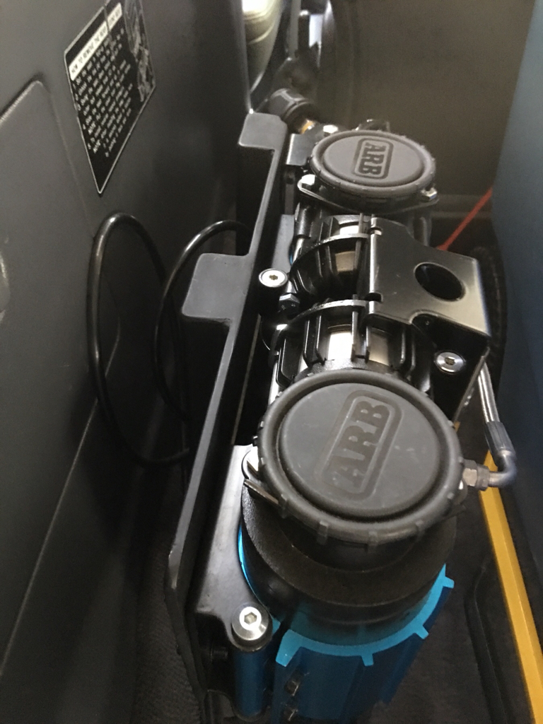

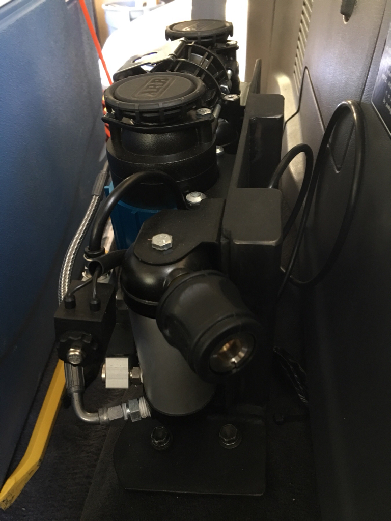

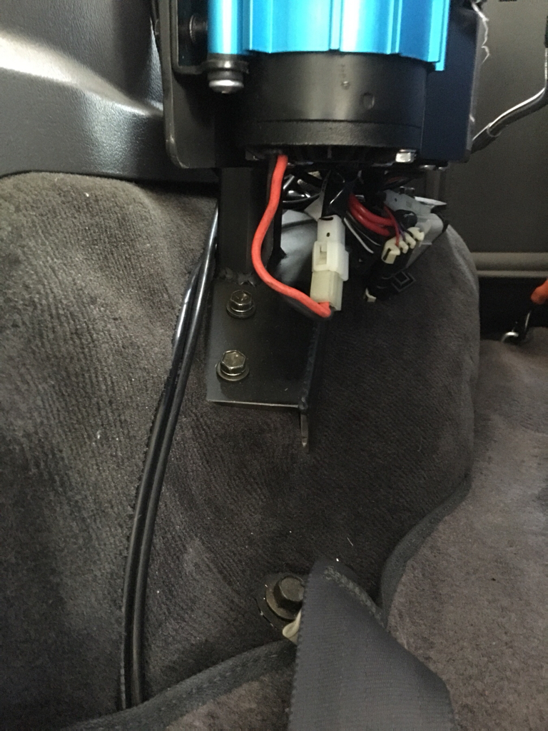

Wanted to show a couple of fabrications we collaborated with Alex at American Overland Expeditions on that came out great. First was an interior mounted ARB dual air compressor. We removed the rear seats and he used the existing bolt holes in the wheel hump to fasten the custom fabbed mounting bracket. He hooked up the electrical, ran the air lines to my rear and front air lockers, installed the switches in the dash, and everything works awesome.

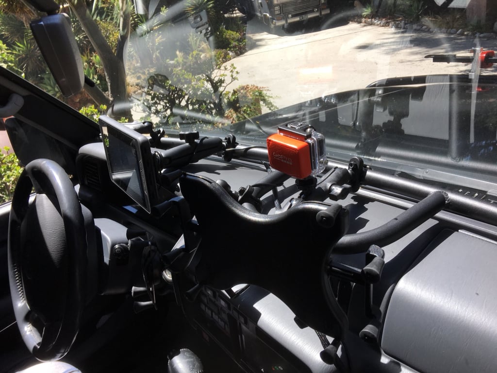

Then I had seen a RAM mounting bar in a Jeep that I wanted in the 80. Scoured the internet and couldn’t find one anywhere. Spoke with Alex, asked if he could build one, and so he did. This thing is da bomb! Rock solid mounting rack for everything RAM. I have my SPOD lighting and battery management tablet mounted, my Magellan TRX7CS, iPhone, iPad, and 2 RAM oscillating cup holders that do not spill! Oh, and also a mount for my GoPro. It’s ridiculously functional. While I was at it, we removed the clock and replaced it with a 2 port USB charger station. I am able to keep all devices on the bar charging when enroute.

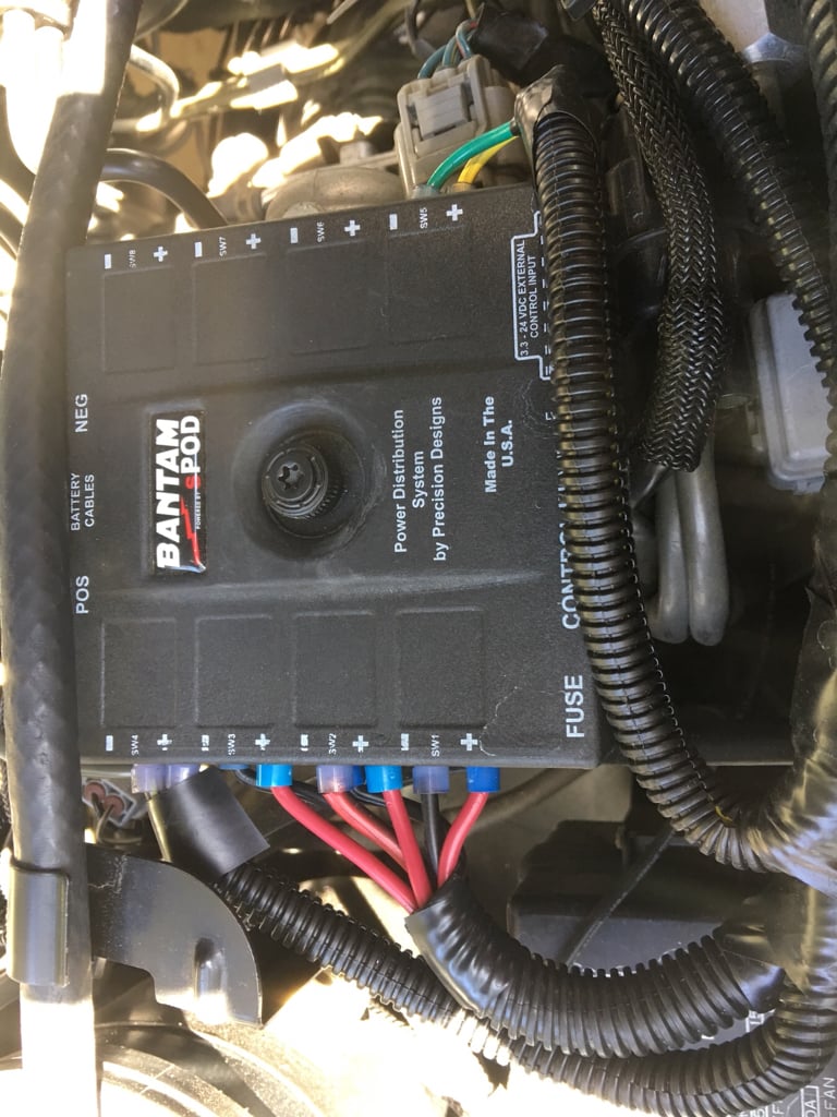

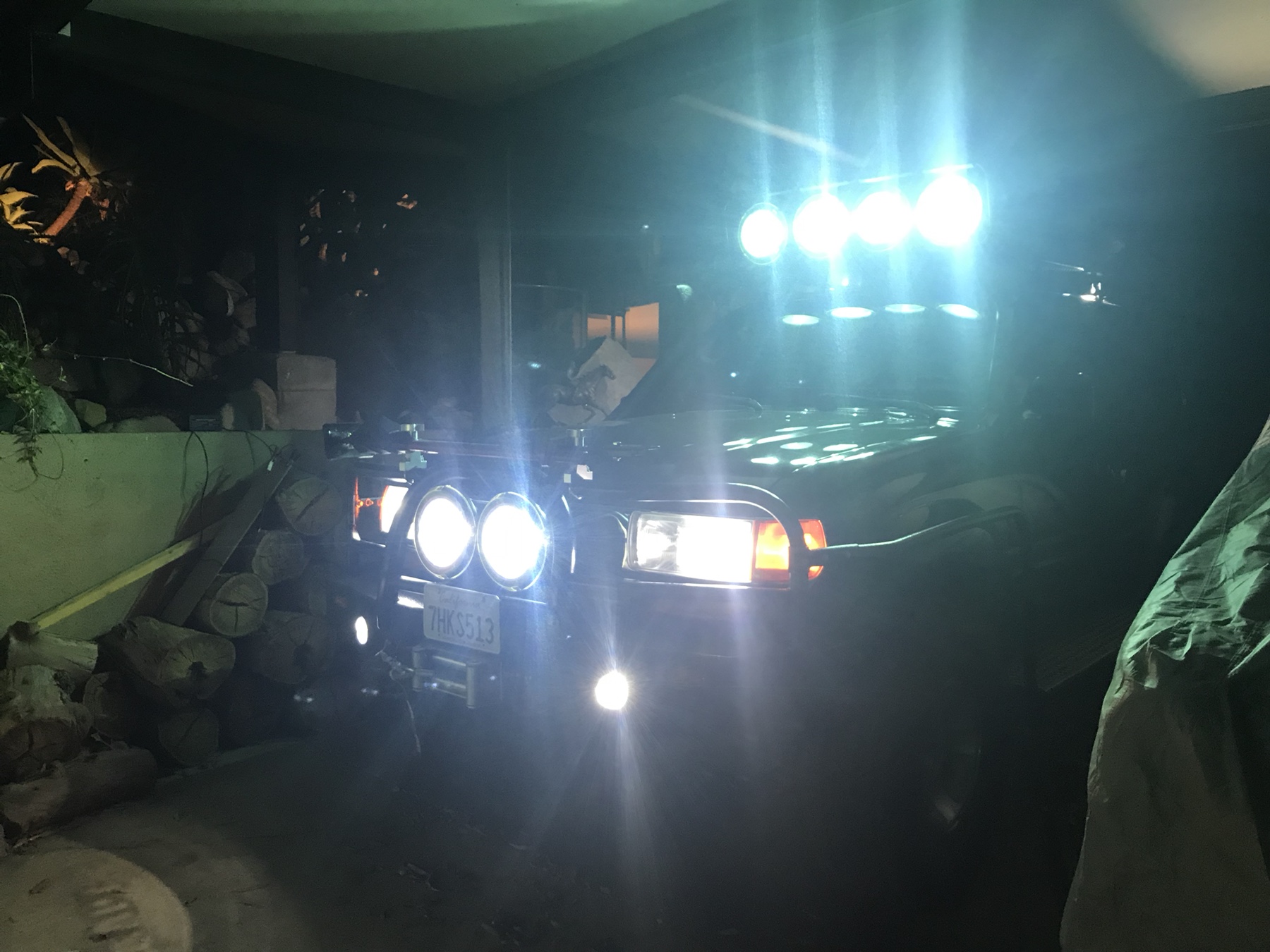

Installed the SPOD electronics management system. I’m using it for my lights and seeing how my batteries are doing.

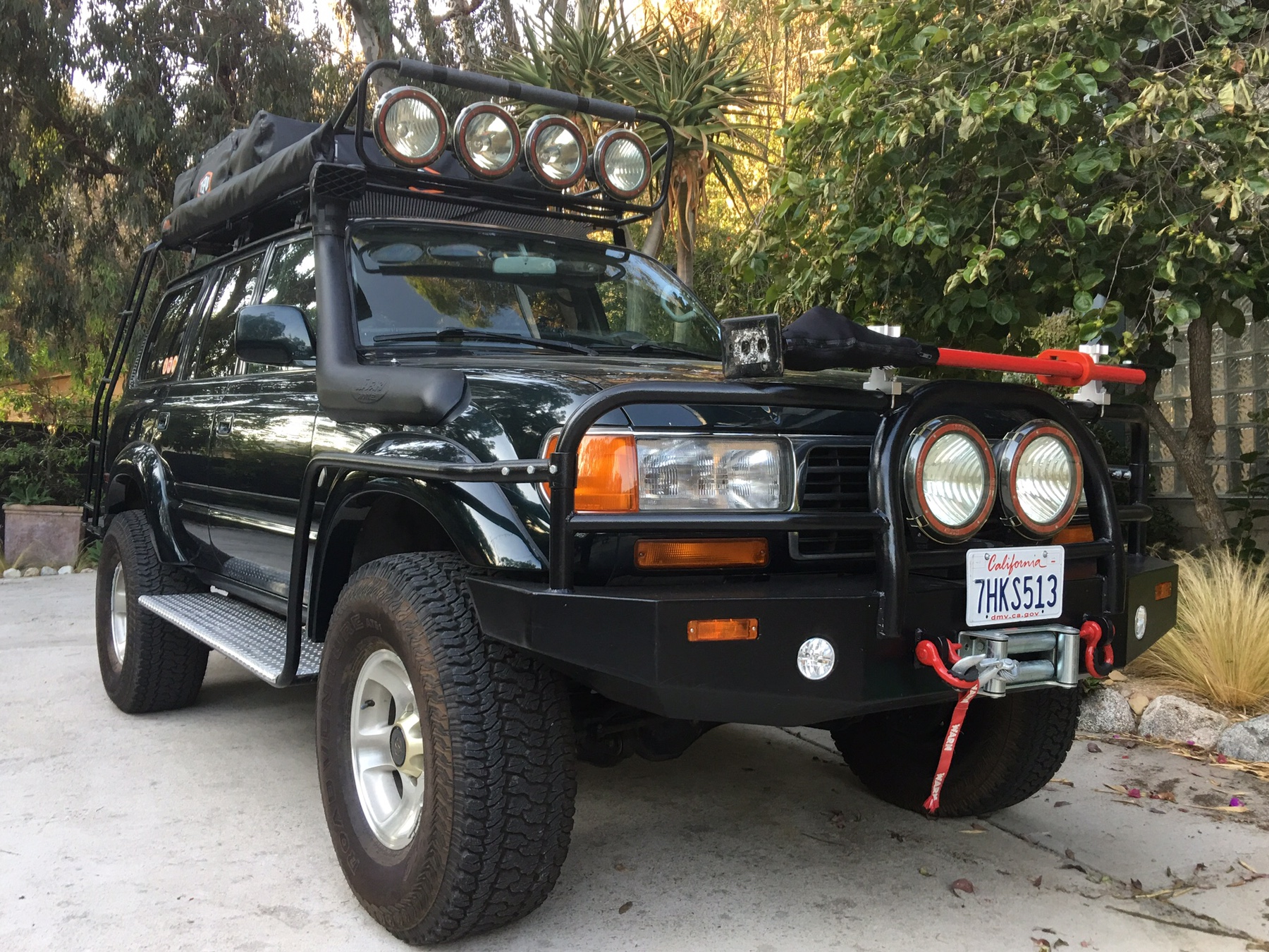

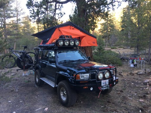

3” with spacers Old Man Emu lift with heavy duty springs. Custom built front bumper and bull bar and concealed 12,000 LB Warn winch. Custom built rear bumper with swing gate spare tire holder and opposite swing Jerry can holder. Custom built front side fender bars that connect to sliders. I will be changing out the rock sliders as I fear they will get torn off on the first boulder they come into contact with. For now, the make a great camp bench! 35” tires on original 16” rims. Both are being swapped out for a new set of 17” bead locks with 35” BFG KM3’s! ARB Safari snorkel.

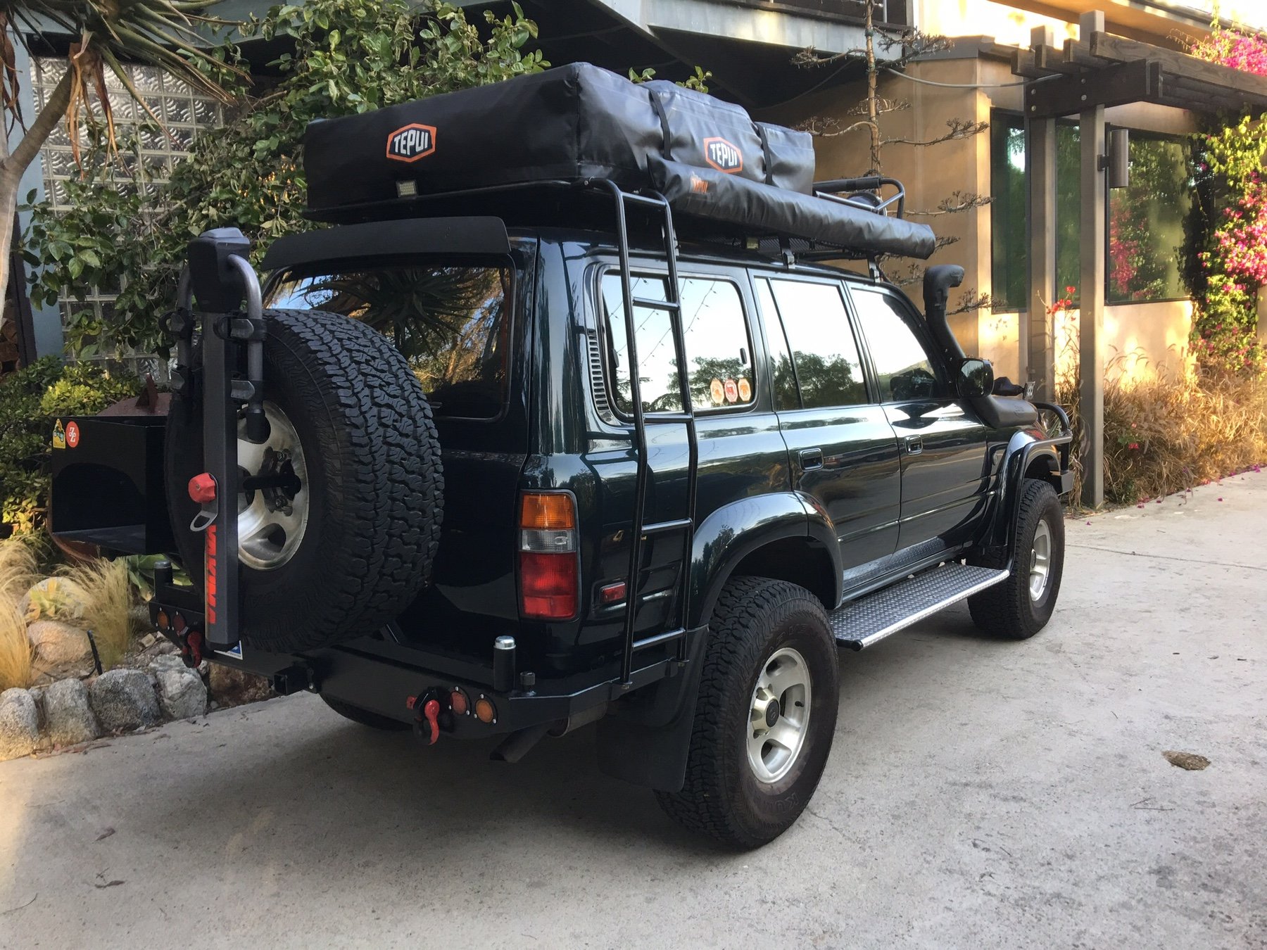

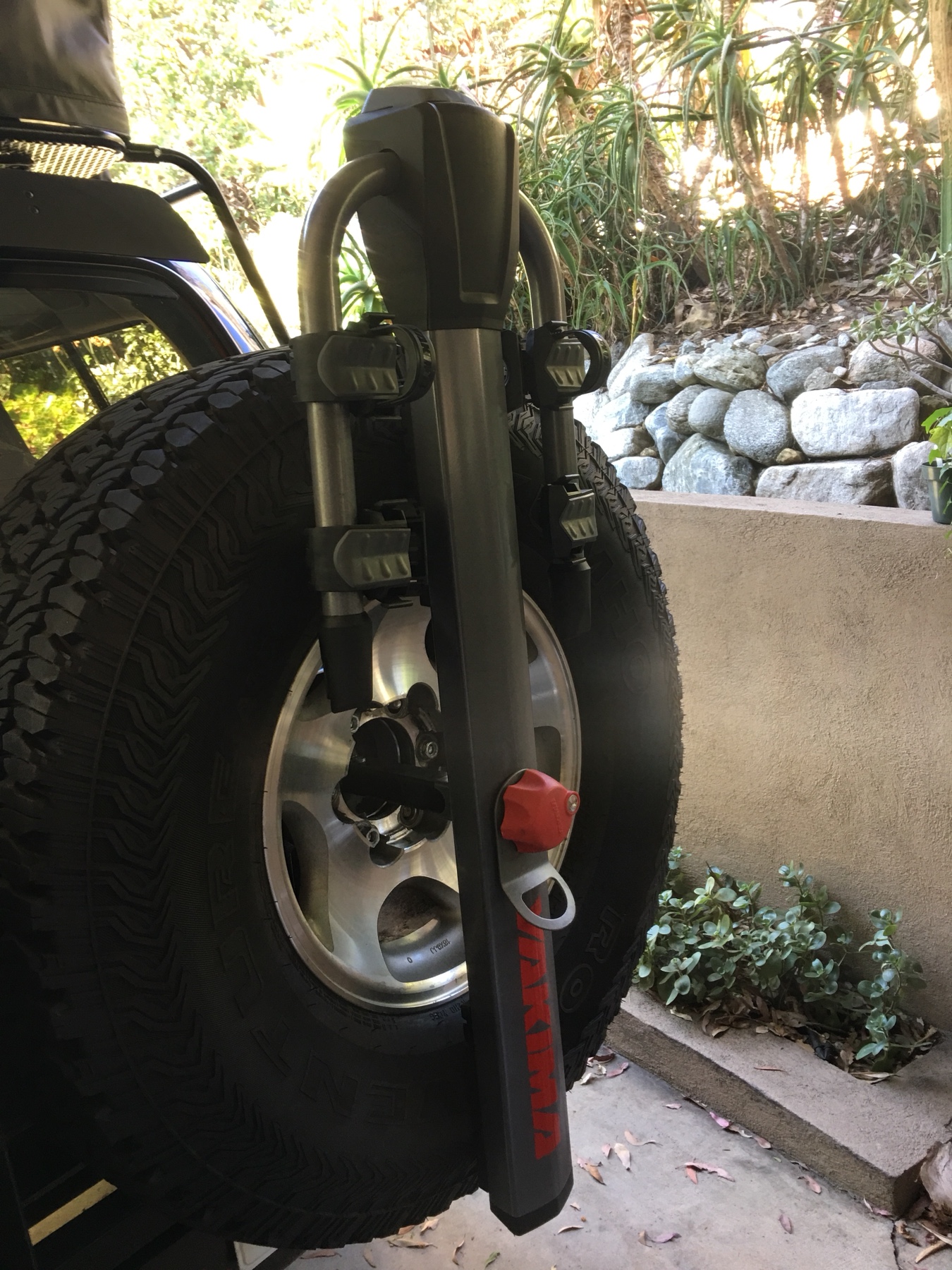

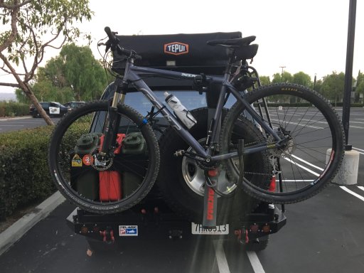

For you mountain bikers who want to haul a bike and have rear mounted spare, do yourself a favor and get the Yakima Spare Ride bike rack. It works great! Bike swings out with spare tire swing gate to allow access to the back of the truck without having to take the bikes off!

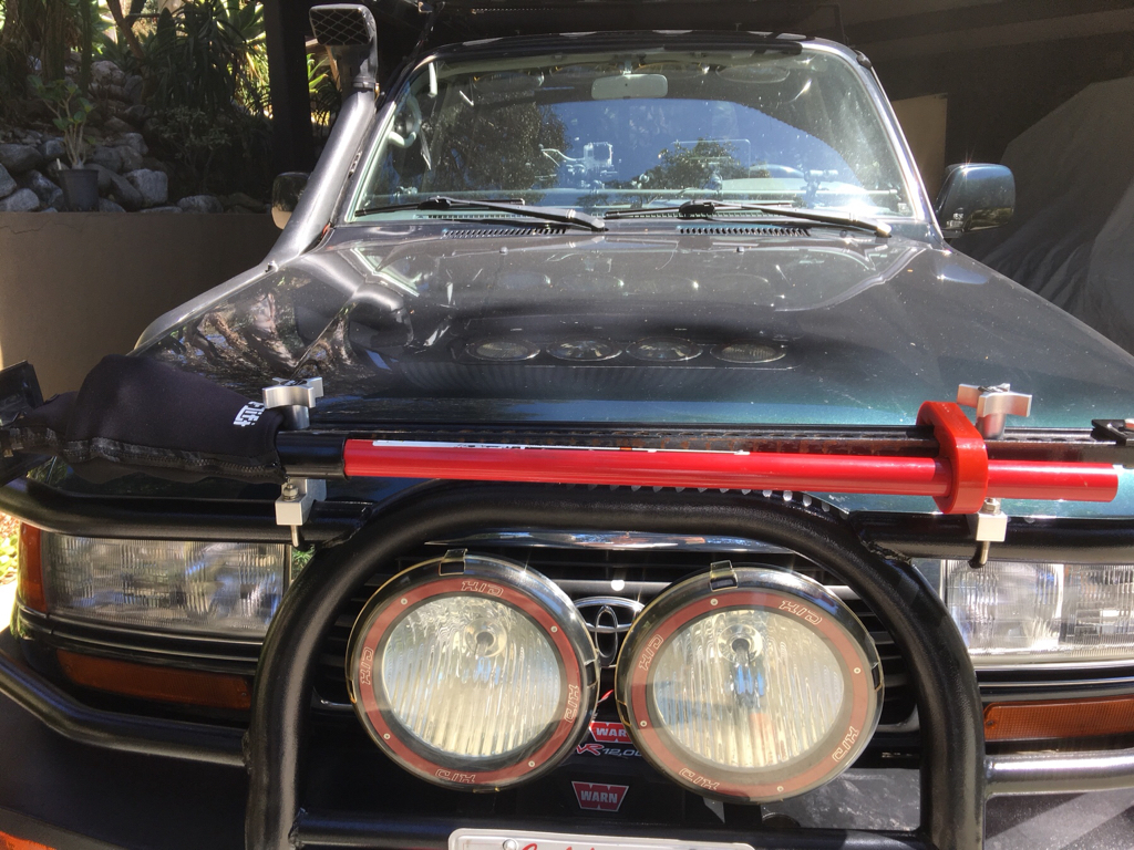

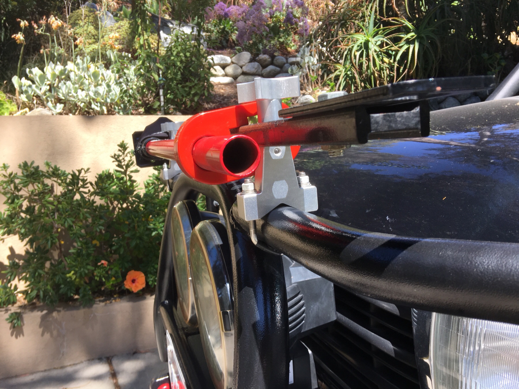

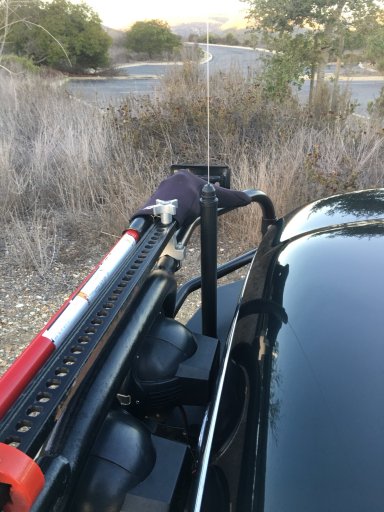

Hi-Lift makes this bull bar mount farm jack mount. Super easy to install. Very clean looking. Doesn’t really impair your vision. And helps free up room for other exterior mounts for things like shovels, axes, Maxtrax, etc...

NZ Aaron
Looks a nicely set up truck. I see you like the Yakima rack. Do you have any picks with it with bikes on. I need something on a Landcruiser Prado and I'm losing the battle on finding a good rack with a swing out door?
Here are a couple of photos. The one shows how the bike swings out with the spare tire gate, and the other shows how high up the bike sits. I purchased the 2 bike carrier, but I think they have a 3 & 4 bike version as well. The one pick showing the bike on the back is somewhat of an optical illusion as it doesn't stick out that far on either side of the rig. You'll notice I had to monkey with the way the bike sits on the rack by shifting everything left so that the back wheel doesn't extend beyond the width of the rig. The bike is a 29er so I'm not sure if the overall length is contributing to that problem. I'll try hanging my buddy's Santa Cruz bike and take some picks to see how it handles that. REI carries the rack. I'm sure they'd let you hook it up in the parking lot to see if it works for you. IMG_3649.JPG IMG_3653.JPG

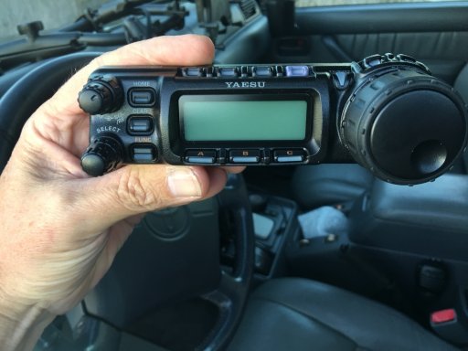

Installed a new Yaesu HAM radio with 2 different band antennas. Also matched it up with the latest greatest Yaesu handheld. Just started my classes so I can get my Technicians license, then immediately onto my General license. Looking forward to chatting with you fellow OBHAMs out there. I purchased it all mainly for safety reasons and emergencies. As I read through the self study guides, there is a bunch of math refresher oriented things to learn. It’s all so very foreign to me. I hope I’m able to grasp it so I can use the darn thing. If there are any classes worthwhile to take....I’m all ears. Self study seems to be the hard way....at least for me. No one to ask questions of. IMG_3666.JPG
