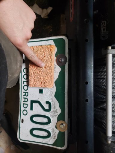

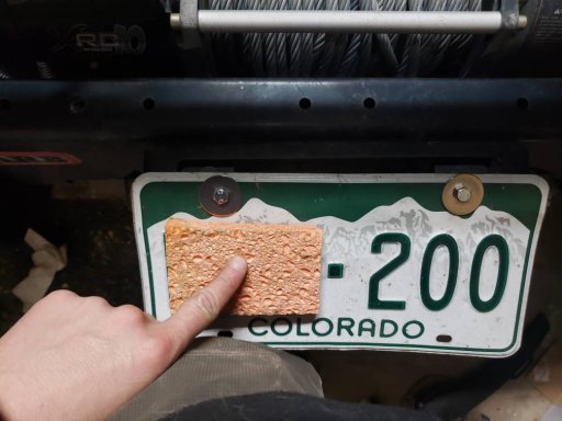

Got the Jeep back. It was just a vaccum line knocked loose. Also had the transmission serviced. Back to the weekend, the spark plugs I pulled were way overdue. I checked gap on a few and they were all .060ish when spec is 040. Serpintine belt was cracking so I'm glad I replaced it. Last thing I did was reaffix the tag up front. It got into a fight with a rock in moab and almost got pulled completely off. Some new bolts and a fender washer fixed that.
