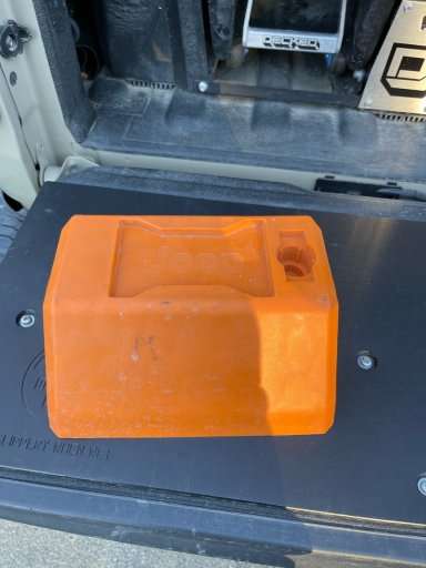

I use the stock jack that came with my Gladiator with the base block. The base gives it more stability and lifts it enough to work with 37s.
Reactions: rtexpeditions

This is the only jack I ever carry. Came with the Jeep.
This is what I'm working with as well though lookin at bottle jack upgrade in coming week or two.
