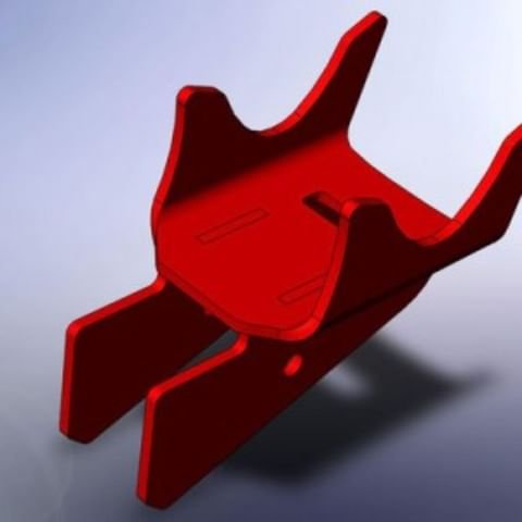

I like having options and do not like being limited, as each has it's place, My OEM lives in it's stock backseat storage slot, I have had a Hi-Lift for years and have added accessories to make it more versatile. It allows options like a Manuel winch, wheel lift separate from a bumper lift etc. I do not take it everywhere I go. The last purchase was a 6 ton bottle jack for my 2500 HD (9000 lb + when loaded ). It's capacity should be ample, and it's size is small enough to be easily stowed. To make it more versatile, I plan to get a axle support cradle which should fit the trucks frame also. This increases safety and when combined with a automotive jack stand allows some peace of mind if working around and under your rig. For most scenarios, the OEM and bottle jack will cover most needs.
footlogo.pngThis allows use on round sliders and bar work and is a attachment to a Hi Lift I have some photos on my Instagram @Desertrunner_ LVOBLogo-Gold_Outlined_100x.png

View attachment 242153This allows use on round sliders and bar work and is a attachment to a Hi Lift I have some photos on my Instagram @Desertrunner_ LVView attachment 242156
I've sent @Dessertrunner_LV a few messages asking him if he makes an axle cradle that fits a 3rd Gen Tacoma stock bottle jack, but no response. The website also comes up a little funky. Anyone know if he is still in business?

I've sent @Dessertrunner_LV a few messages asking him if he makes an axle cradle that fits a Amazon 3rd Gen Tacoma stock bottle jack, but no response. The website also comes up a little funky. Anyone know if he is still in business?
-----------------------------------------------------------------------------------y---------------------------------------------------------------------------------------------------------------------------------
My apologies, as I have not seen your sent MSG's. I have not made any bottle jack cradles, but have toyed with the idea, as those offered for sale are way, way overpriced for what is offered both in labor costs and material costs. The main obstacle for me being I do not weld. I found a few offered on the internet, 1 offered by Amazon,. but all costly. If you have access to a welder, you could build a couple for various applications.
PS.....Safe jack offers 1 for a 6 ton at $50, E-bay for $54.99 etc
Thanks Dessert Runner. I am leaning towards the safejack options and buying a 6-ton or higher bottle jack separately as the jacks seem to be to one item they sell that is not made by them, just private labeled and then jacked up (pun intended) from other similiar models.
The Tacoma OEM mechanical jack actually has a pretty good top height of about 19" so I was hoping to find an axle cradle that fit that, but seems no one makes them. I think in this thread someone said they inquired with safejacks about making one and they said not interested. Which I totally understand.
