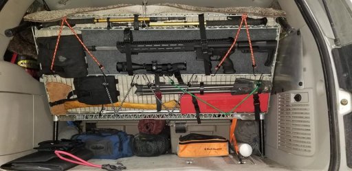

That's a nice, simple but usable setup. I like it. I've been thinking about sleeping platform options for my WJ, and I think I tend to over-think it a LOT and let my mind run wild with crazy setups.
-TJ
They are very simple yet strong these shelves are rated at hundreds of pounds most hardware stores have them. We have a kitchen supply store in Reno that carries them in a wide range of sizes and you can buy them one shelf at a time. The only cutting is the poles and I drill holes through the mounting points and put a screw in it to keep the poles from falling out when lifted. In the Tahoe I have seat mounts on the floor and use two ratchet straps to hold it in place. You could also use turn buckles to hold it down.
I use the carpet to close up the slots to keep small things from falling through and to make it more comfortable moving around on it. I just zip tie the carpet in place.

Ok doing a bed platform I love mine and it gives me a place to sleep without setting anything up... I don't take passengers in mine so, I removed all the back seats to give me a ton of storage space and all of it is very low to the floor. The fastest, lightest and easiest way to install a platform is by using wire frame shelving. Just pick the size that fits in your rig and cut the legs to the height you need some legs will be longer or shorter due to the floor of your vehicle no big deal just cut to fit. With planning you could complete a platform build in an hour...
If you want more details or ideas on setting up the inside for camping check out my build thread in my signature.
A 5 inch thick full size foam mattress fits over the platform and now I also have a 37 qt refrigerator under there too.
It is easy to make them lift up for better access too. Mine lift up in the back and in the front only the center section remains in place.

You can put all sorts of things under there. Also Molle gear can be installed on these racks too they have the same spacing.

Those are MTM Ammo crates they are Exterior 19” x 15.75” x 8”(H) The case on the right is a tool box the one on the left has food water for a week and a hiking stove and water purification pump. In between is recovery gear, sleeping pad and snow chains. The PVC tube is used for holding large shooting targets. I carry sleeping bags for two also, their size is dependent on the season.
