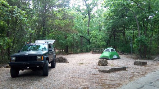

Those LC's/ 4runners/etc allow for a larger tire (about a 32" from what I can find) with a stock suspension than your XJ would.
The XJ can fit a 245/75/16 (metric 30" tire, a more true 30" tire than an SAE 30") with slight rubbing on the fenders, and then you load it down with gear and the clearance issues won't get any better.
If you are ok with running smaller tires or cutting fenders then it's your call on lowering the XJ.
To me the stock XJ was too low and had limited suspension travel, not to mention little tires.
I run 4.5" lift and 265/75/16s (32x10.5) as I wanted to keep the stock flares, I still rub a bit when turning and cycling the suspension but now I sit up as high as a stock JK Wrangler. :unamused:
You add heavier bumpers, a winch, gear and the height will come down a bit as well.
I don't think the lift is either needed or excessive, it's up to you and how you want your vehicle to be equipped.
I like the way it looks and performs and since I am still using stock wheels and AT tires it has a very stock look to it.
